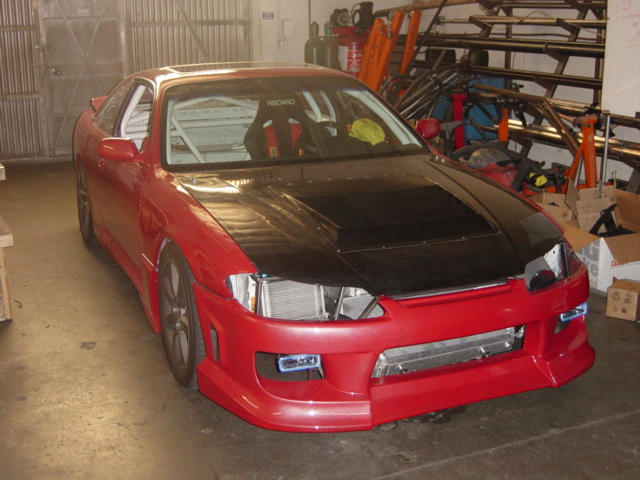

my S14 project is almost done.
i just installed the Aim Sports MXL dash a few days ago and just wanted to show it off.
i dont know how to post pics up can anyone help?
its also on
http://gtfabrications.com/gtf_pg/thumbnails.php?album=7
scroll to the bottom of the page and you'll see the dash.

very nice...whats the mods so far and what are the plans?...beautiful machine

here are the mods so far for the
GT Fabrications S14.5
hks 272/264
crower springs and Ti retainers
greddy rocker arm stoppers
WCCH port/polish head
apexi head gasket
ARP everywhere
wiseco pistons
eagle rods
fake greddy oil pan
RPS race clutch
B&M short shifter
SARD injectors
koyo radiator and XS I/C (GTF V-mount)
electric water pump
custom catch tanks
GT2871 (stock manifold, no time to make my own yet)
greddy turbo elbow
GTF DP and Exh.
aluminum drive shaft
kaaz 2 way LSD
Z32 rear knuckles (aluminum)
GTF custom brake system
Sparco steering wheel w/ quick release
steering quickener (1.5 turns lock-to-lock)
tein tie rods (inner and outer)
Phase2 custom harness (all fuse blocks removed, now on resettable fuses)
tein flex suspension (drift set up)
AP racing 4 pot calipers up front with PFC 97 compound race pads
GTF 10 point cage
Aim SPORTs MXL digital dash
zeitronix wide band
greddy profec-B
custom re-programmed ECU from a awsome tuner in japan
Percy's speed glass lexan windows
(quarter windows for now, i'll have the front and rear in by the end of march)
odyssey PC680 dry cell battery
S15 front end with carbon hood from wholesalehyperformance
and vent from B-TUNE
red carbon sunroof cover (sounds fancy but wee just riveted a flat piece of carbon)
stock 350Z (i have the WORKS XD9 in Bronze on the way and should be in by end of march or april)
recaro SPG bucket seats
SABELT 5 pt harness
i think i covered everything. i did most of the work myself including building the engine. If it blows up i can only be mad at me. i know my cages are good i had a few customers test them out already so i'm good there.

yea man looks good, nice parts list too, post pics once its complete

Impressive man
