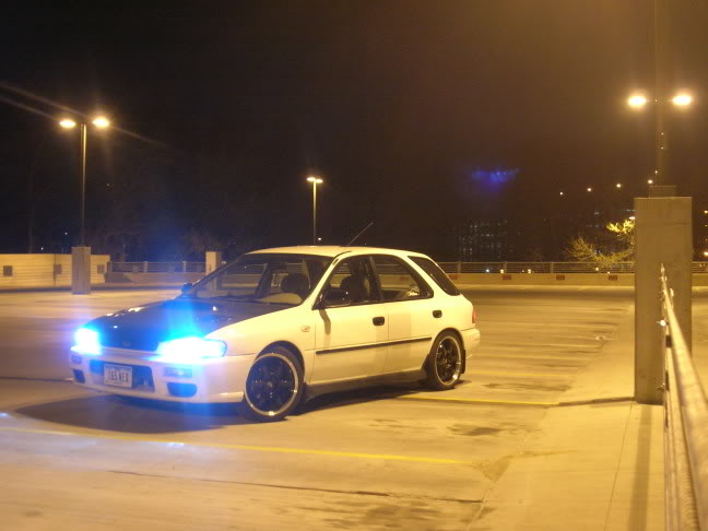

That is my impreza. I've had that McCulloch 8000K HID kit for 3 years now. I got it from hidplace.com They are not fake taiwanese kits. 3 years ago i really liked the blue look and that is why i bought these. never had a problem. These are actually straight from japan.
Old May 18, 2006 | 04:14 PM
yes you do have a problem. you put hid burners in halogen headlamps and you are basically driving around with blue *** high beams all the time, your beam pattern is non-existant. not to mention 8000k produce about the same number of lumens as halogen 3200k bulbs
