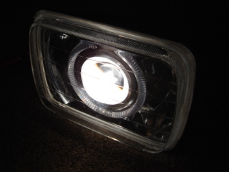

Well The HID's Lexus uses are Designed for a reflector Type such as the IS300's, it's a D1R bulb. It has a shield on the bottom to keep a proper beam pattern. Also the BMW's and such use projectors, it has a cut-off the only time it blinds you in when the hit a bump and the front lifts up, it's not a constant beam of light in your face.
Your housings were not designed for HID's thus you have a ****ty beam pattern. Yes you have more lightoutput but now other ppl can't see. Yeah you can aim it down and in but your only reducing how far you can see.
also +1 on 6000k but to each his own.
This would be my solution for that:

Yeah I aimed them down so the shine on drivers isn't bad, about like any other HID and the distance I can see is still more then I could with my factory headlights.
Also, I may end up getting a set of the projector headlights for the car (non halo type) after christmas. I'll just sell my other lamps and the bulbs that came with them. Won't be hard. Just not sure on projector headlights. I owned a set on my last car (98 eclipse) but they ruined the headlight beam completely. An they were name brand projector lights too, maybe cheap eBay ones will work better, lol.

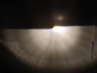

The only REAL hid's are oem hid projectors and associated parts made by phillips, bosch, kioto, hella, denso, mitsubishi, stanley etc. here is something to consider:

Yeah I know now how a projector lamp actually works. 6 years ago when I had my old projector lights I did not have HIDs in the eclipse, so I couldn't see much of anything at night and switched back to the factory lights. So this time around when I asked myself if I wanted "standard" headlamps or projector type headlamps I remembered back when I had projectors and they sucked. So I went with plan old headlamps. Which are working just fine for now and are working just fine for the hand full of people I locally know that have aftermarket HID kits.
Sometime I will end up swapping over to projectors and when I do I'll do a comparison like I did above, with the bulbs. I still like my HIDs and don't regret spending the money on them.
