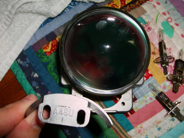

Alright, heres what im working with
dimensions: 3” clear lens, 4.5 inch wide, 5 inch deep

stock there lots of yellow at cutoff, but a fairly sharp with nice flare. In order to mod it the “bars” must be cut off the shield in order to push the shield closer to the bulb. To do this I used a dremel and a cutting wheel.
should look like this when finished
no before after pics right now but you can imagine how it must look (a lot like fx xenon projector probably)
