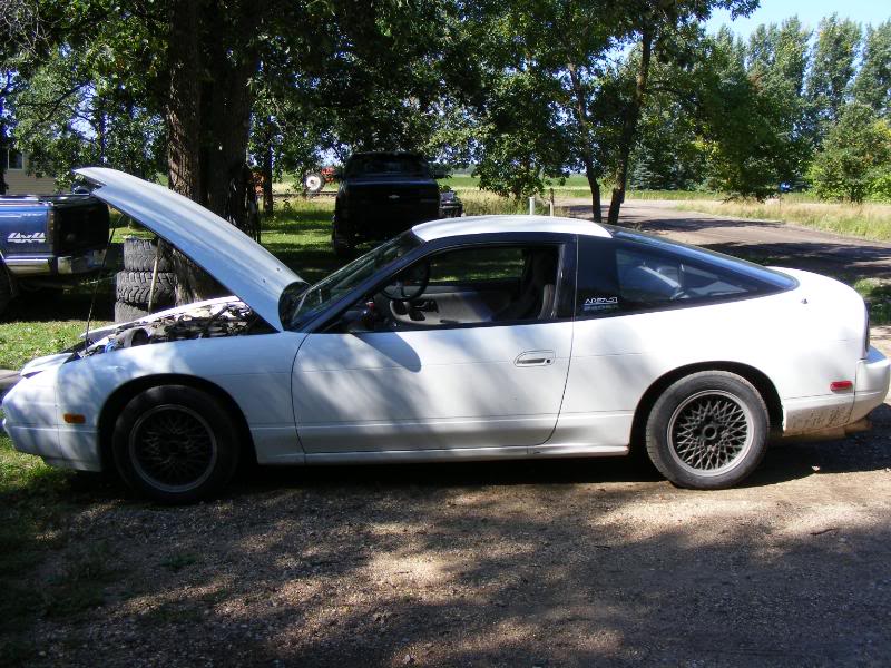

Well To start things off I pick this car up in April '09. This is how it looked.
Stock Ka24de with 148,000 miles, Cold air intake,Sr20 injectors,My mad tyte one of a kind bride detachable hub! It's legit, horn button says so. SAFC2 controller.

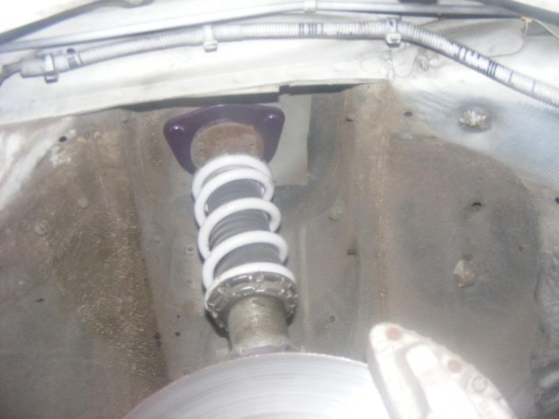

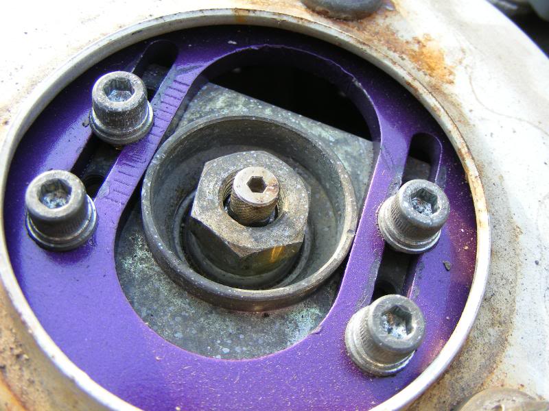

Then fast forward to September of '10. My shocks were alright but I wanted something different. So I started looking.

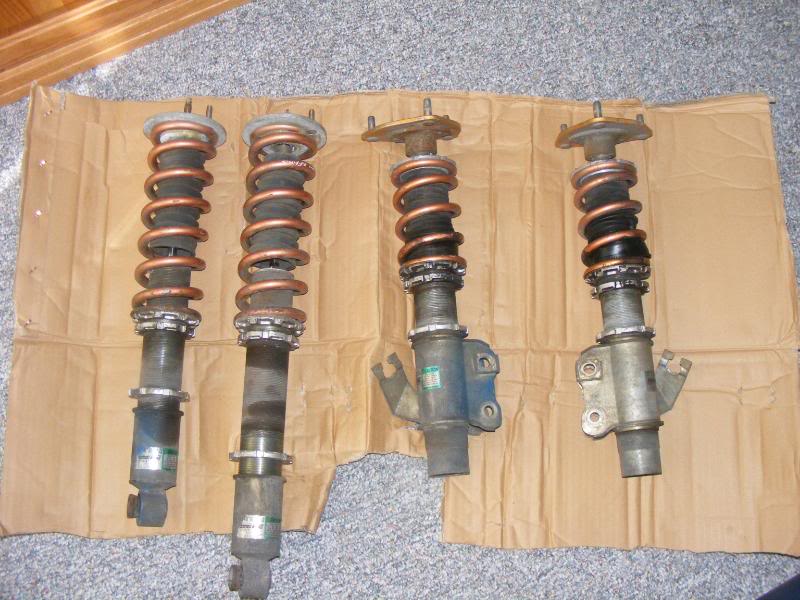

Picked up a used set of Tein drift's with Swift springs. I got a good deal on them with about 6k miles.Going to be swapping these out when I get the funds for something new.

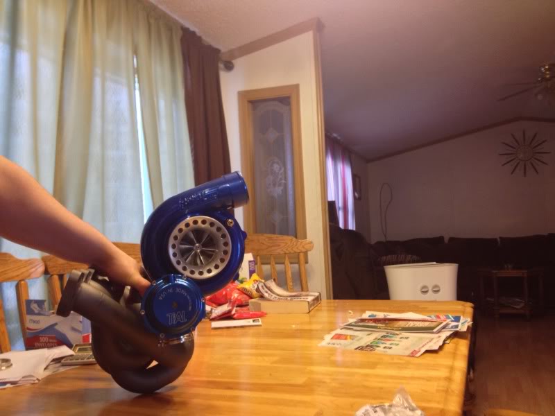

So the week after selling my truck I called up Robert at Zerolift and worked out a deal and picked up an Rb25det,Engine, Trans, ECU. I also got a Mountkit from Zerolift and a 1 piece driveshaft.
Then I ordered a couple more goodies the next day. Greddy style intake manifold.Name:  Rbswap025.jpg

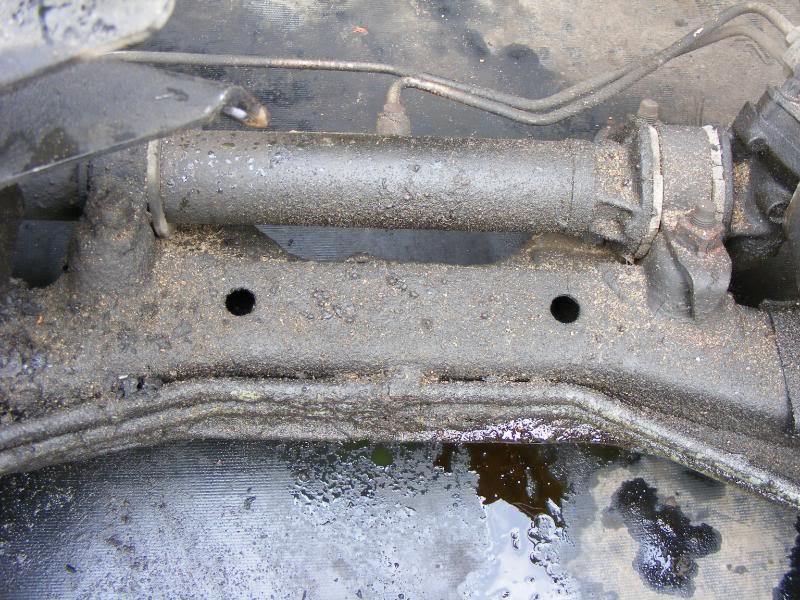

Need to clean my rack and pinion
Little bit of rust

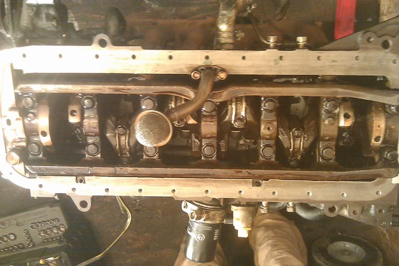

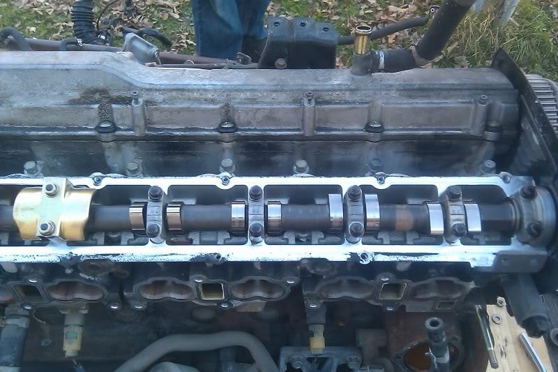

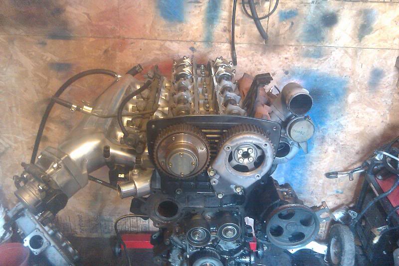

Then the engine shows up and I start tearing it apart.

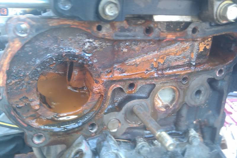

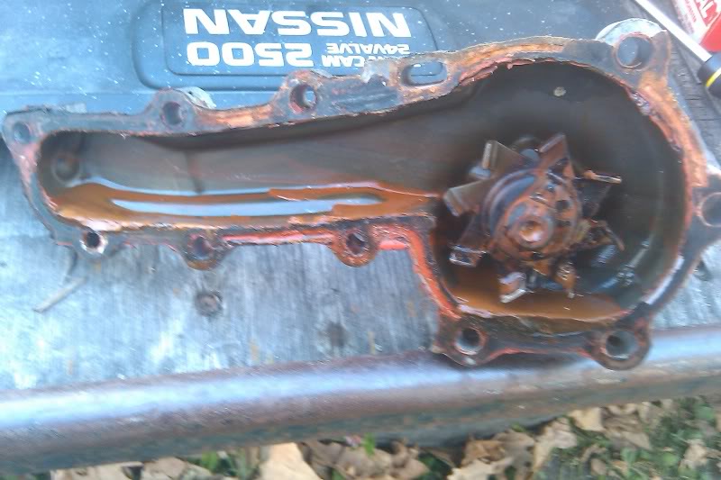

The whole engine is very clean,apart from the coolant that looks like someone **** in it.
After cleaning it out and flushing the whole engine coolant with water it was good.

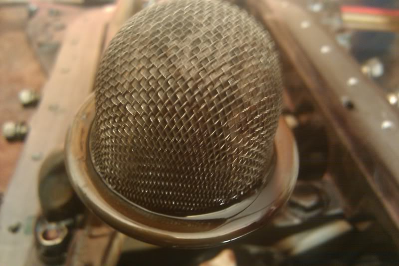

Oil drained,Which I swear was 7quarts of oil.
Intake on and the engine starting to come back together. Just waiting on Clutch and waterpump and Thermostat.

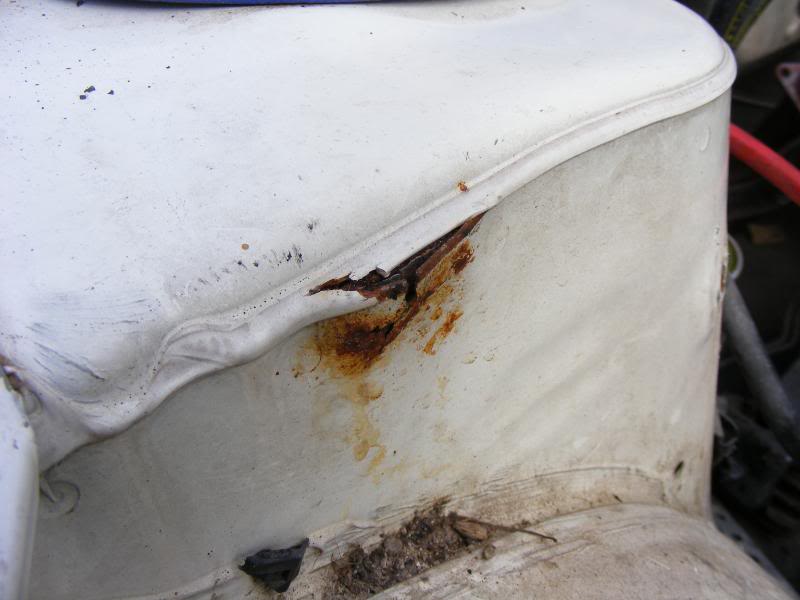

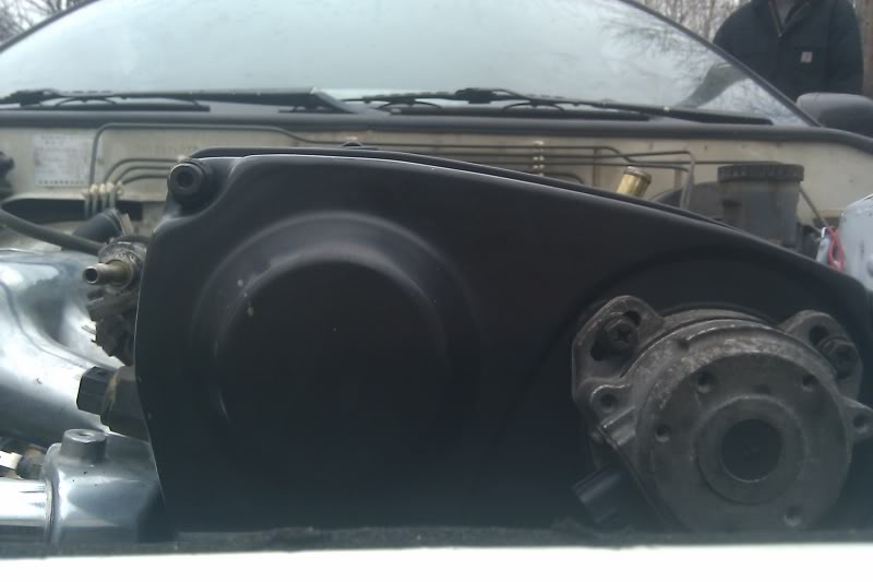

Then before winter hit I had to get the engine in or else I would have to wait since I am doing it all outside.
So after fixing the rust and spraying over the welds to prevent rust(don't worry engine bay will be painted when I remove the engine again)

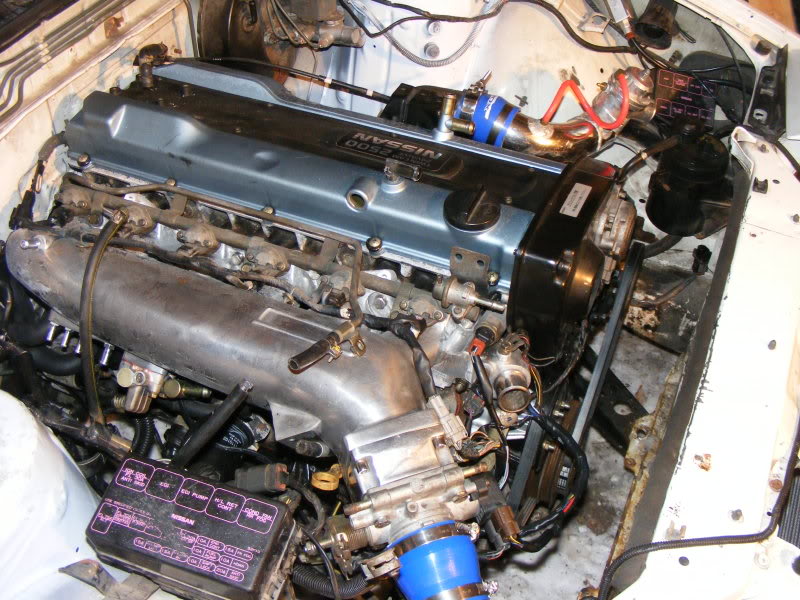

Getting the engine in was kinda sketchy at first. But when I got underneath and jacked the tranny up while lowering the engine and loosened the motor mounts it slipped in place.

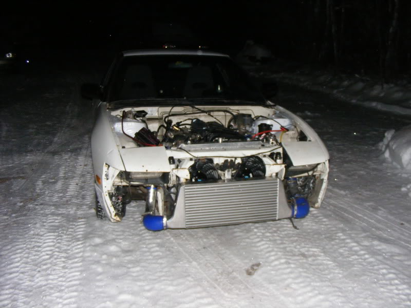

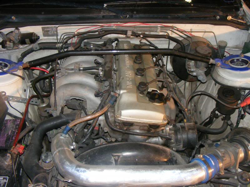

I then picked up a used Intercooler kit with a BOV for cheap, and started to install all the little things.
Intercooler and piping on.
I also picked up an Isis MBC
Everything was done besides my turbo outlet and and air filter.
So I contacted Skyo performance and got there turbo outlet to mate to my sr20 downpipe and clear my steering. Great quality. Awesome customer service.
Then I picked up an apexi air filter.
After starting it and driving it everything ran fine but there is a couple of more bugs I need to work out. More pictures to come.

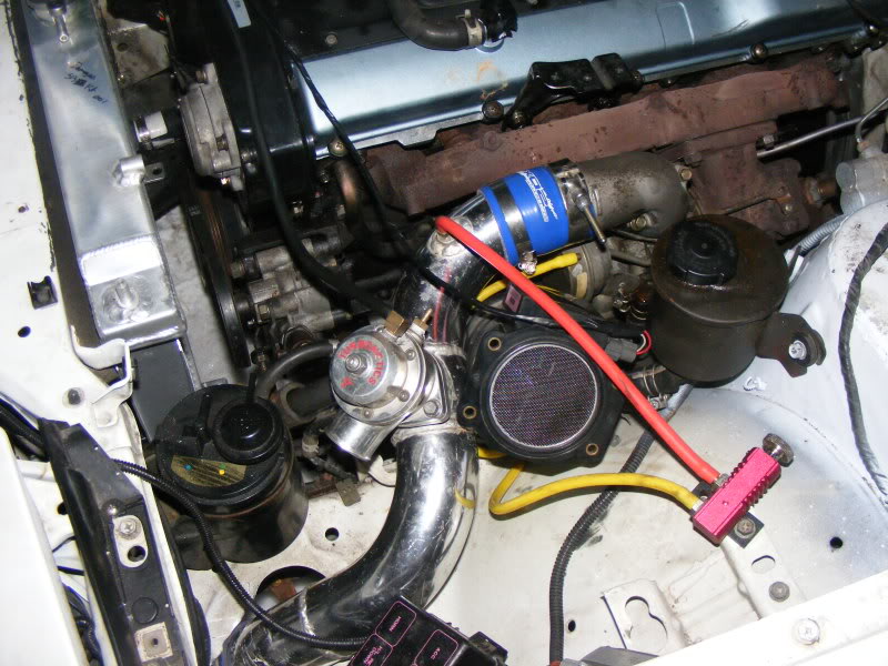

nice build but just a bit of a warning that manual boost controller is set up wrong.
it needs to be hooked up to a vacuum source and its hooked up to the charge pipe it may cause you to overboost and blow your motor the first time you step on it so just saying.
Vacuum is only available from the intake manafold after the throttle body btw
Thanks man! It was acting funny. I teed it off from the FPR. When I ran it like that it actually worked pretty good besides causing surge and doesn;t work really. but for some reason I cannot boost over .5bar. No matter how I hooked the BC. Or opened the valve on the BC it just stayed at .5bar. Then one time my hose slipped off and I boosted 1bar once for a few seconds. Also, If i step it down about half throttle just to enter boost at about .2bar and try and hold it there the engine starts to cut out? and fall on it's face. But the moment I step it down to hit .5bar it goes with no hesitation.
The only things I have left are, Walbro fuel pump,Adjustable FPR. I'm not sure if either one of those has something to do with it not being able to boost higher.
The only other things I can think of is my BOV spring tension is too loose(had to loosen it) and is bleeding off the pressure after .5bar? Not positive I am probably wrong. Or my BOV needs to be recirculated. Or I have a boost leak someplace.
I like how I post this up here and a day later I get the answer I was looking for on how to run my BC. when everyone on Zilvia said the way I ran it was fine. Makes sense why I was getting a lot of surge.

.5 bar is about 7psi which is stock boost. you might have the hoses on backwards it only works one way
also on that stock turbo dont go passed 1bar thats about 14.2psi which is its max efficiency
Well before I ripped the sticker off it said the bottom one goes to the wastegate. I think it shows the arrow on the picture I have of it.
I was only looking to push 10psi. I would never push the turbo over that. I can't really feel the full potential of the RB since I am breaking the clutch in and the roads are icy.

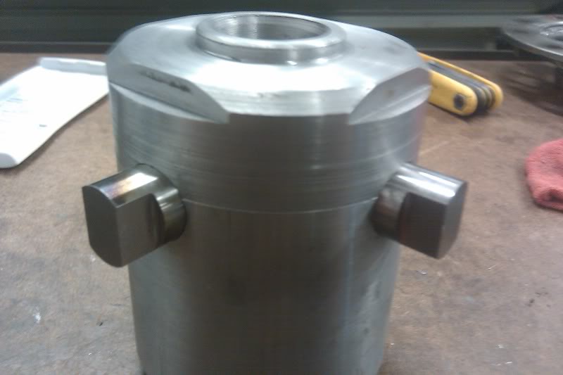

I also designed and machined a mini-spool which replaces the internals of the vlsd, which is probably going in my spare differential I have laying around.

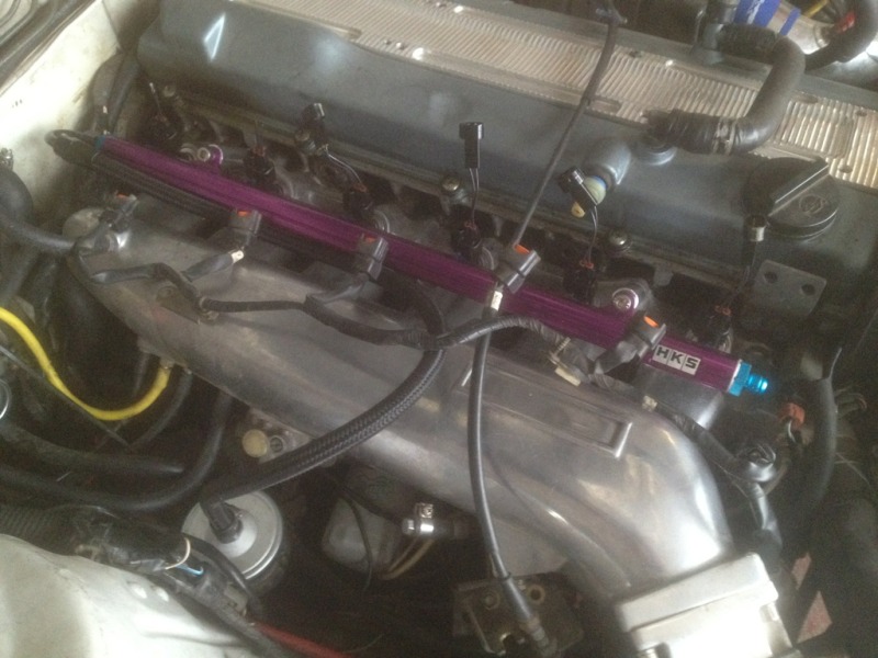

Purchased an AEM ems series 2, hks fuel rail, 1000ccID injectors, aem wideband gauge and some fuel line. Going to convert to e85.
I got everything wired up last night besides installing the wideband o2, which I'll finish today. I need to figure out something for my fuel line. Basically need a fitting on my aero motive fpr. Tonight I'm going to syphon my fuel out and add e85 and do a test fire.
Here's some pictures, Dicks.

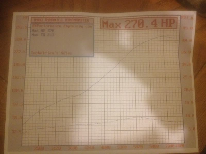

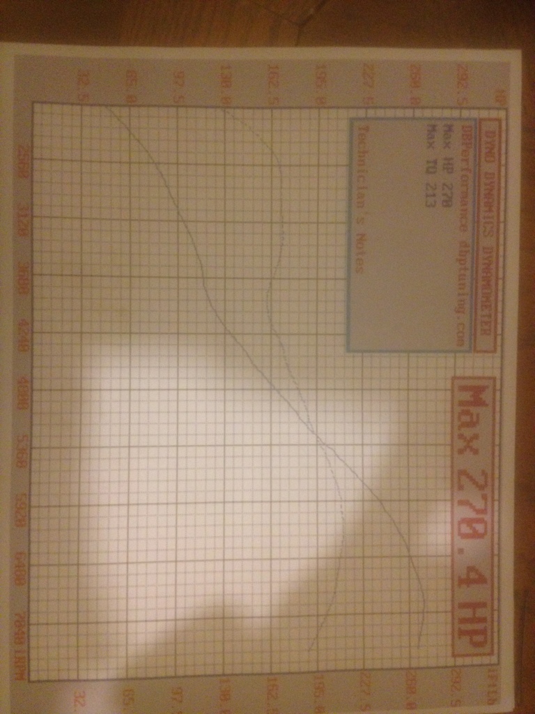

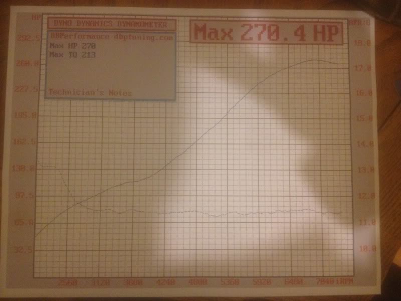

UPDATE!
Is anyone on here anymore? Don't really see much activity on here.
Anywho, got back from the dyno a few weekends back and everything worked out! Sitting at 270hp/213tq at 10lbs. The car feels so much more lively. I must have been limited quite a bit with the stock ecu cause the power increase is astonishing!

Come on brethren, we need some action in this forum!! I'll leave you with a lil somethin
To be continued....(2.6l stroker is in the works)
