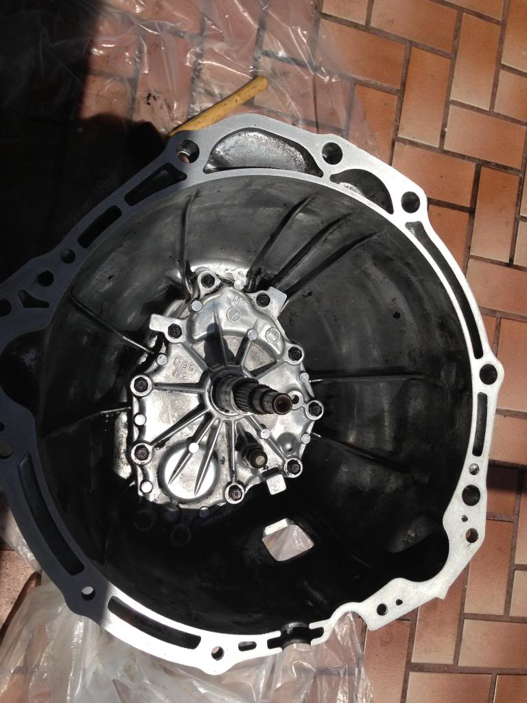

got the bell housing from the machine shop they did a good job

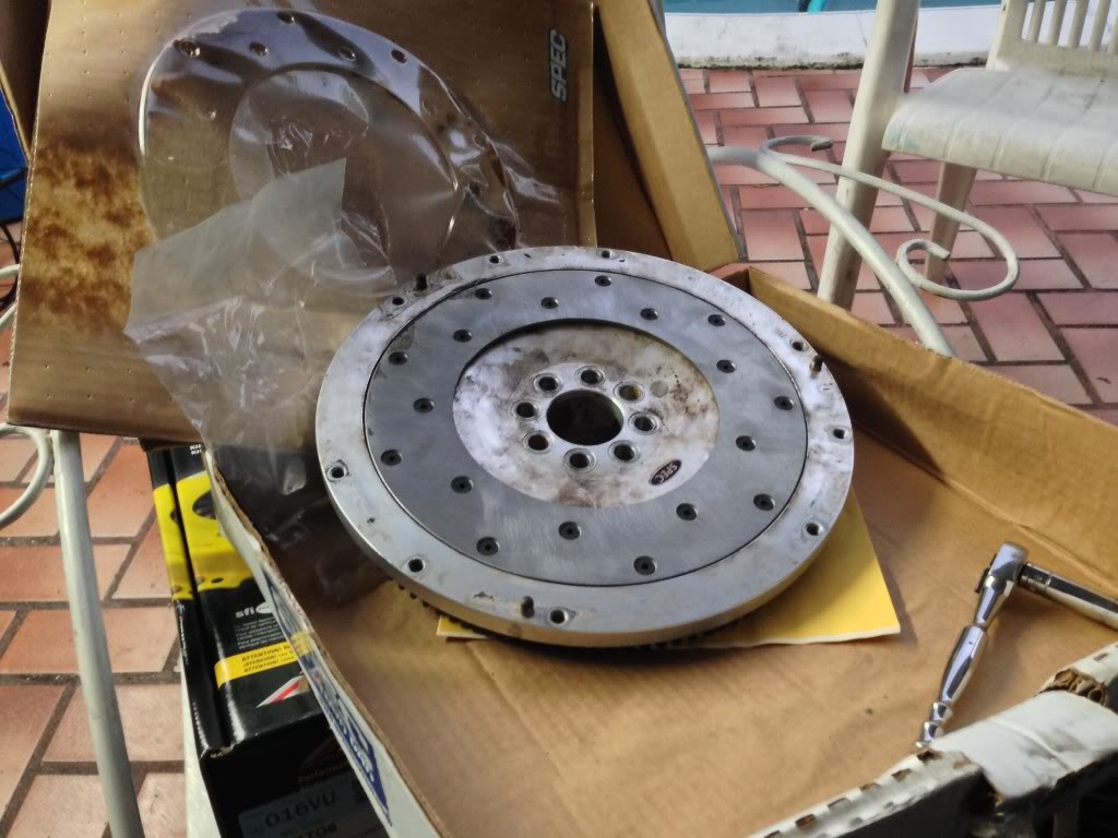

i already had the Spec flywheel but i wasnt sure if i needed a new friction plate or not so i just ordered one it was $80 i would be kicking myself if i needed it and not ordered it but other then that im still waiting on more parts and i will try to pull my SR out of my s14 this weekend

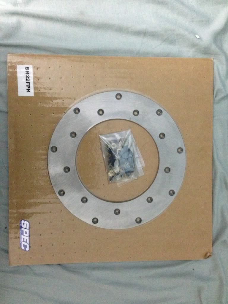

my replacement spec Flywheel friction plate came in today. now im just missing a few parts but they happen to be the most important ones

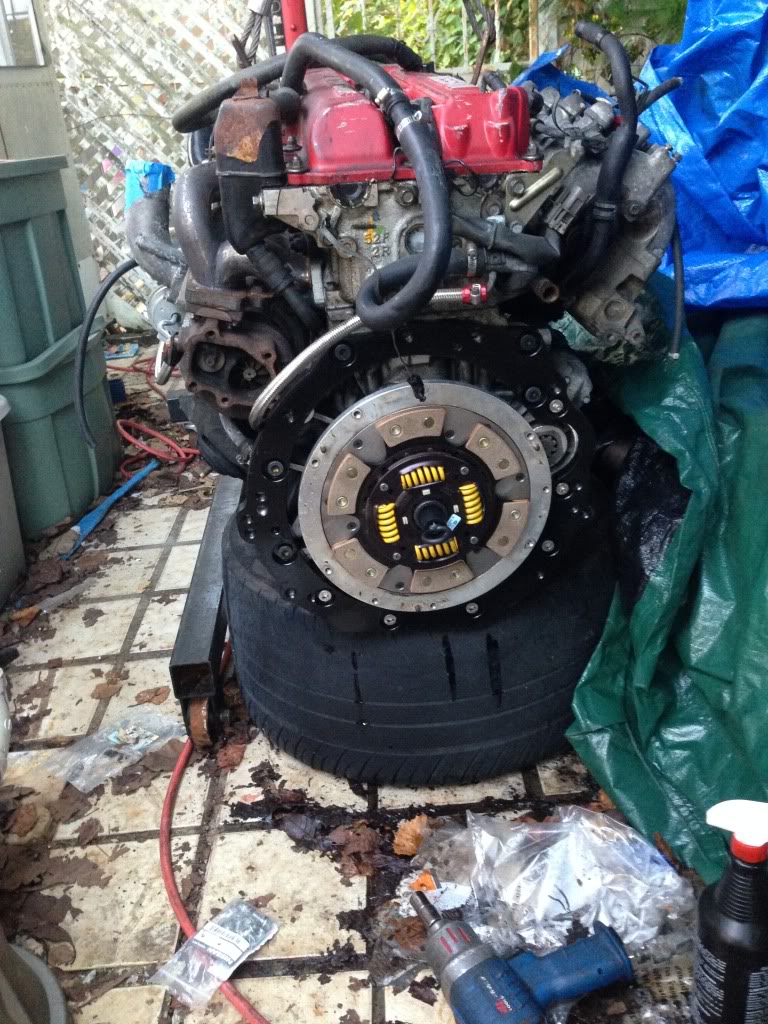

here is the adaptor plate with the fly wheel and clutch going on.

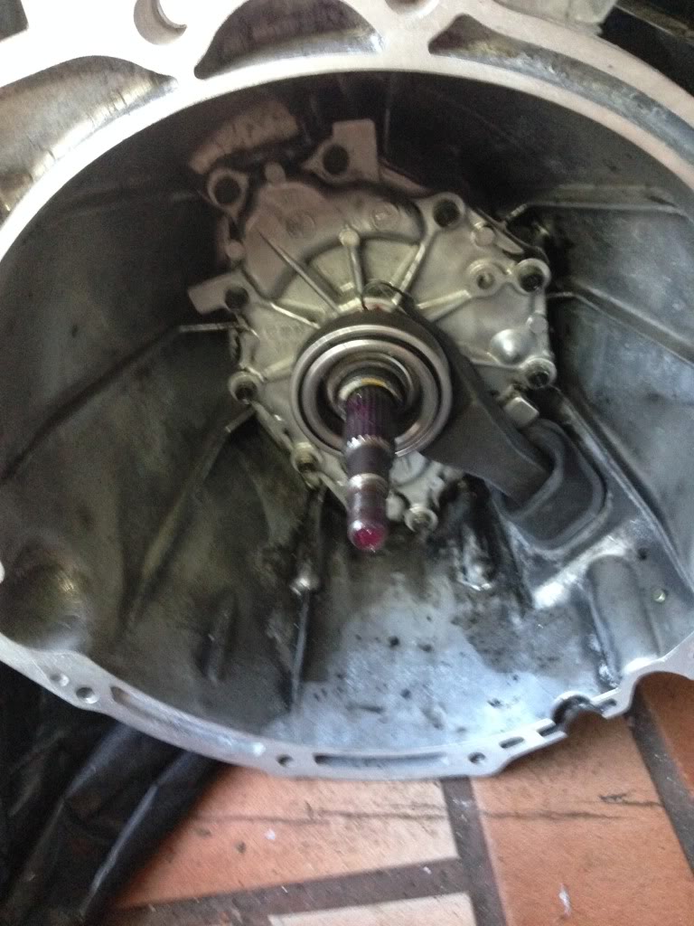

now here is where i ran into my first problem, im using the SR bearing carrier with the Z33 fork and z33 spring clip.
left is SR spring clip and right is z33
it ll went together fine but when i mated the tranny to the engine i find that the fork has full movement and does not even reach the pressure plate. my solution is to buy the collins bearing carrier made for this swap but i had thought the SR one would work.
