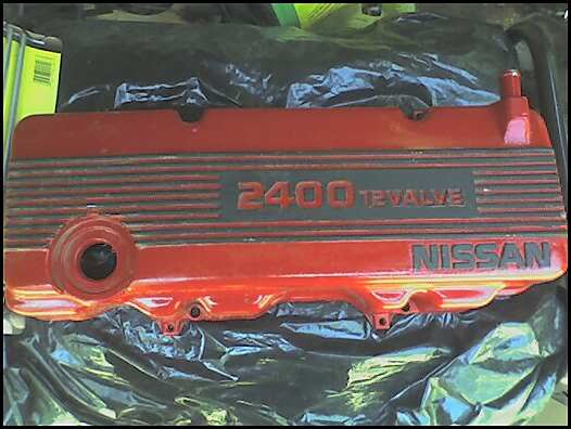

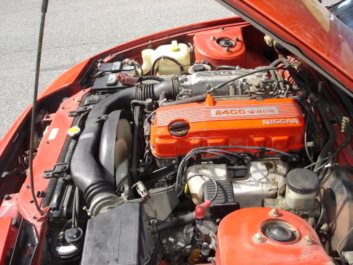

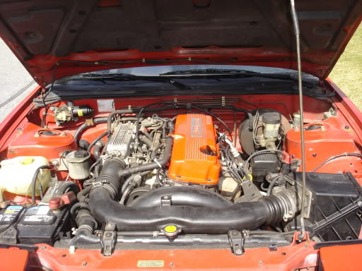

Hey guys! Had a little project this past weekend.
I painted my valve cover red.
Took a little while to mask off the silver parts, but it came out really nice!
NOTE: It was REALLY sunny when i took the pics, so the cover looks orange, its very glossy. I'll take some pics when its darker to get the true color. I used Duplicolor: Chrysler Industrial Red Engine Enamel.

looks pretty good Very smooth, what did you use to remove any old coating? i love to see how others did their covers. I love mine too.

To clean 16 years of ****, I used F21 Wheel cleaner (cover is same material as some rims), and 360grit Sandpaper. I also used some sort of house-hold cleaner.
DONT USE STEEL WOOL, that will put deep scratches that will show through the paint. AHH!
360 grit is good stuff, just right for this job.
I...
Sanded, 5 coats primer, about 5 coats of paint, wet-sand, coat of paint.

PS. I didn't brush the letters, i sanded with 360grit and taped them off when i sprayed, that is the color of the stock head.
