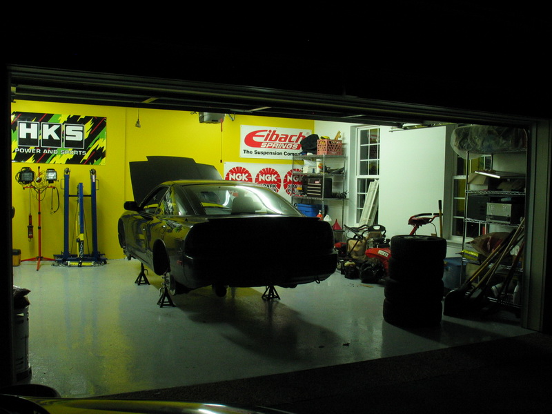

Here is my favorite garage picture:

Yeah that picture is amazing. And nice work man. I'm painting my room orange today hopefully, (I just moved again.) So if i have anything left over..... (:

Holy crap, wish my garage was that clean! Good luck on the car too!
