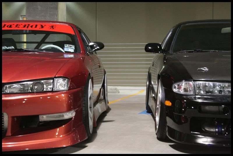

17x9 with a positive offset is an easy fit.
A: Roll Fenders. ALWAYS roll fenders.
B: 9jj = 235 MAX.
C: Camber, son.
Dish?
Uh..there's plenty of rims with dish, but you have to ante up.
If you're looking at sportmaxes and FN's, Just stop now.
18x9 +4 up front.
-2ish camber.
225/40's.
Viceroy aproved.

the s14 on the right is about where i want to be. but 17'' whats the exact spec on that car?

they look like fiberglass wide fenders on that black car, that will change things a good bit. what is your price range? you could even get some aftermarket mustang wheels with a decent lip.
I agree, those are wide body front fenders, stock would never look like that lol
And those rims look more like 18s instead of 17 on both of those cars... Anyways, if you want the "deep dish" look, you gotta spend more $ for a decent look. Your looking at about 300 / rim like the Gramlight 57Pros, like the ones Hubert Young had on his D1 car, go here:

Not, He drives a green car.
It's Stewart's.
I'm not positive on the black cars specs, I'll go find out.
Maybe.
That's not flush enough tho, IMHO.
