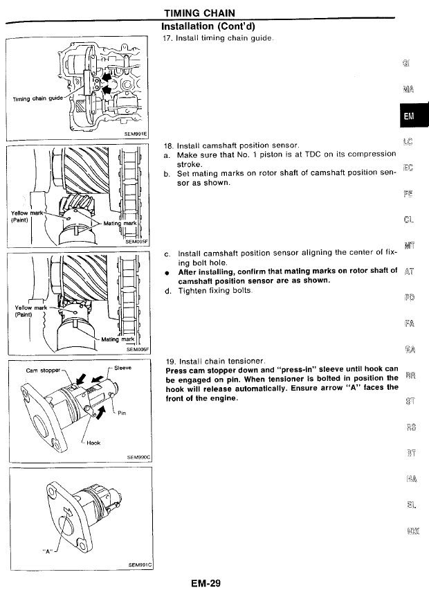

you might need to set ingition timing back to stock i adjusted mine a bit but it wasnt perfect then i installed my new cams and i put the timing back to stock and ive never had a problem starting the car since.
heres the FSM
pretty simple if you want to do it your self.
heres the FSM

either put it back to stock like the diagram shows or u can get someone to be in the car and you adjust it to see if it works.
imo putting it to stock is very very simple
take out the CAS 2 12mm bolt and a plug. take off vavle cover. put the motor tdc. alight dots on the CAS like illistrated then put it in tighten it plug it put the valve cover back on and you should be good
