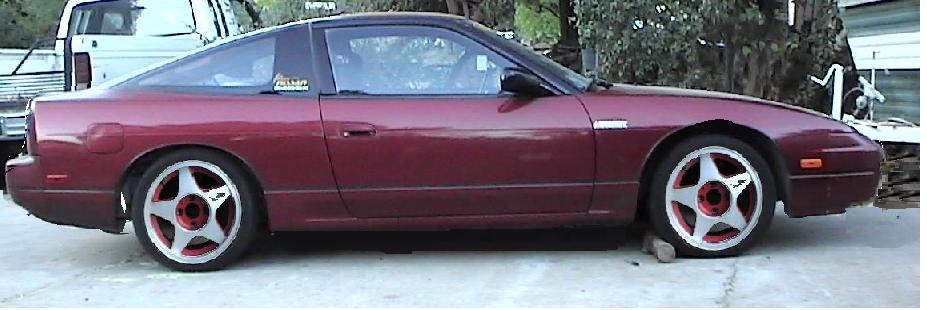

Here is a pic of the rims photoshopped onto the car,
Does anybody know who makes these? I Really wanna find the other 2
