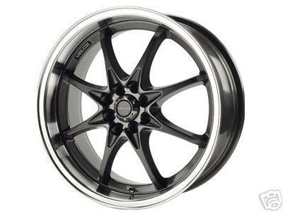

yo wuzz up look i got some velox vx- 8 18's gm but no tiers now i was just wandering if them rims will look raw on my 240 i got a 90 with a 92 front red, hit me let me what you all think peace..

And I like velox wheels..well most of them. Im sure they will look nice, get some rubber on em and put em on! And take pics...

get at least a 8" width with around a 30's offset...a low 30's. those might be for fwd so be careful

I know one of the workers at Velox, those wheels are primarily for FWDs (actually most of their wheels are for FWDs). He gave me the specs:
Wheel size : 18x7.5"
Wheel weight : 25.5 Lbs
Available offsets (backspacing) :
+40mm (5.82")
Available lug-patterns :
4x100mm 4x108mm (4x4.25") 4x114.3mm (4x4.50")
It'll fit your S13 if you have the 4 lug on it (not the 5-lug conversion) but the offset might be a little off.
