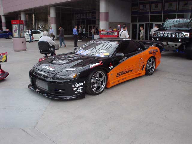

just wanted to know what the offset on the wheels on the back

We cant tell just from a pic.

I know that 17x8 and 17x9 are perfect for the S14, and they are prolly really good for the S13 as well.
BTW, offsets for perfect fit:
F - +27
R - +35
Old Feb 24, 2004 | 08:17 PM

I kinda like Russ's look.
18x9 +19 all around.
Keep in mind, he has wide fenders up front and a LOT of negative camber.

cleannnnnnn 240 there
doesnt that rub tho?

If that guy has that much negative camber to fit his rims, wont that ruin his tread? I'm pretty sure, and please correct me if im wrong, that if you have too much negative/positive camber, you get uneven wear on the tires. I'm probably wrong, so i guess my answer is a question..

It does rub, but only rubs the inner plastic lining. He's about to get smaller tires. Those are like 245/40/18 that came off of an R34 Skyline. He got a STEAL in those wheels. 18x9 Volk CV-Pro (3 piece) with Bridgestone runflat tires.
And, yes, over a period of time, you can get irregular wear on the inside 1/2 of the tire from running too much negative camber.

DAMN, is that a 3000GT?? WOW!! I'm impressed. I didn't even realized that 3000GTs can be that modded out. cool. makes me kinda regret selling my VR-4. But oh well. I'm pretty sure it cost that dude a butt-load to get it that modded. Especially if it's a VR-4. But where did you guys "read" about that car from? I wanna read about it and the RX-7 with an SR20....
