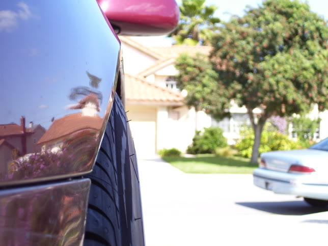

This is just under being flush to me
And thats 17x10 +12 in the Front

Not bad but what is tire size (and mnfr? I cant tell
Those are stock fenders I believe, or are the aftermarket or stock modiffied.

Those are stock front fenders that are rolled.
Tires are 245/45/17 By Cooper

damn, 10 inches wide in the front? sheesh...
