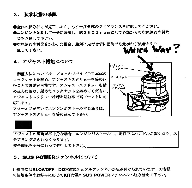

Since I never learned to read Japanese, anyone know how to adjust the Blitz SS Dual Drive BOV? Mine (bought used) has only about 1/4" of thread out the top... In other words, do you back out the center screw for higher pressure, or screw it in for higher pressure?

NVM, I got that part figured out. Now it looks like I may have the heavy spring installed? Guess it's trial and error time...
