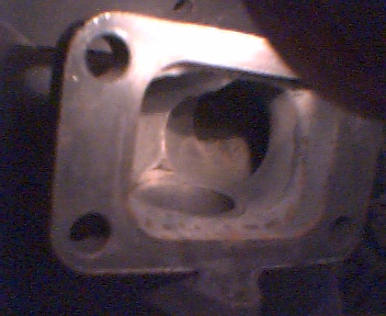

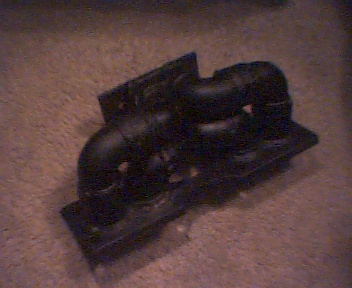

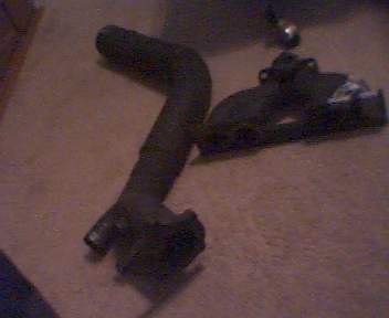

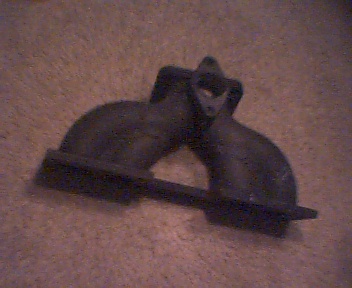

Hey. Here's some pics of the manifolds. The first few will be the 600$ one and the last will be the less expensive one. If it is a daily driver the cheaper one would be the way to go. Also, if you do go with the cheaper one you may want to bring it to a shop that fabricates and have them rework it for about $100 and you would basically have the same manifold as the other. The only difference is the other one has massive downpipe (3"). I'll let you decide. If they don't sell they will be up on ebay so don't think you missed out until they are actually sold.

pic 2

pic 3

pic 4

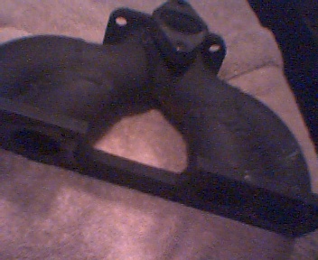

Sorry about the lighting but I had to use my webcam photos and there is not much light, even with a flashlight pointed on it. The above pics are for the $650 manifold and the below pic is for the $200 manifold. Now again, this manifold does need a little work for hardcore applications but for a basic budget turbo manifold it will work just fine with low boost. Here you go. If you don't think that my prices aren't fare just email me with a bid and after a week I'll see who has the higher bid, but if someone thinks 650 and 200 are fair they will go strait to them. Kinda like "Buy it now" but I'm not ebay. My email address is Hollowkostik@aol.com.
