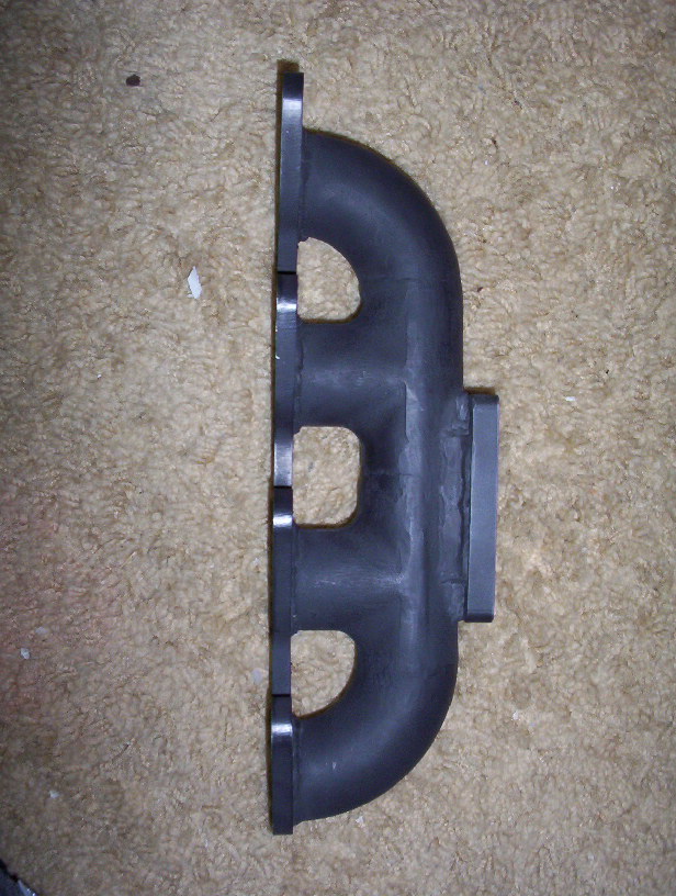

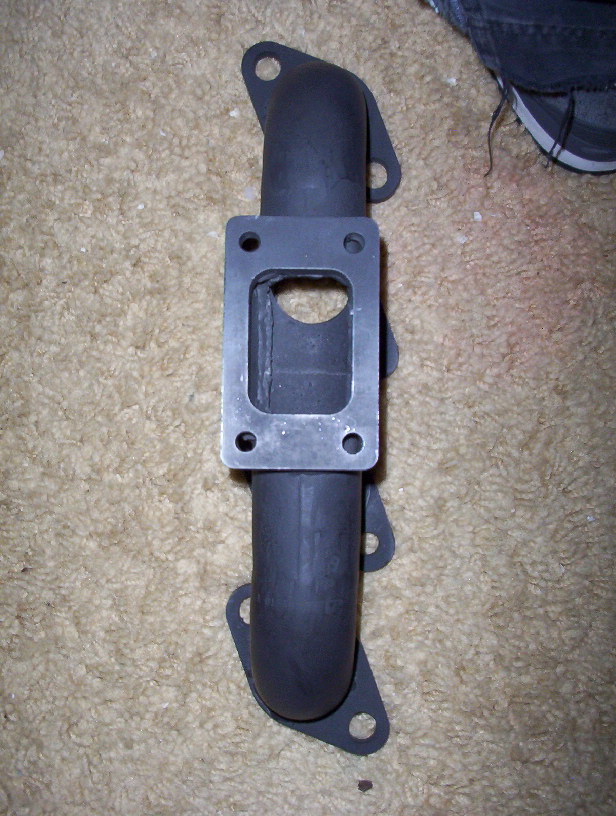

yup it is kinda strange it is a t3 manifold, short with the turbo flange facing the side, not up or down, but to the side.
Old Mar 22, 2004 | 03:07 PM
adavib's Avatar
Posts: 178
From: Charlotte, NC
side pic of the mani

Old Mar 22, 2004 | 03:08 PM
adavib's Avatar
Posts: 178
From: Charlotte, NC
another pic of the mani

Old Mar 22, 2004 | 11:49 PM
ftrs13's Avatar
Joined: Dec 2003
Posts: 60
the oil casings for the two turbos are the same, whether its watercooler of just oil cooled. you can run the watercooled turbo without water ... in fact thats what Im doing right now. just give it adequate time to cool down, as you would any turbo and you will be fine.
