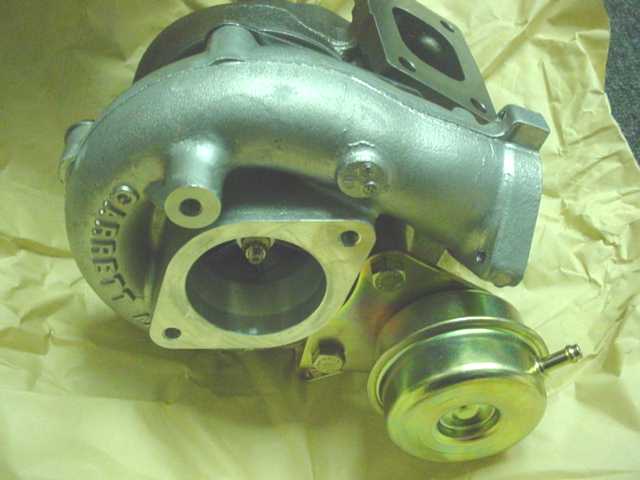

Make sure you get an " S15 T28 dual ball bearing", the S14 is different, they have different part #'s
Attached Thumbnails t28 turbo question-phase2motorsports_1775_4349884s15t28.jpg
