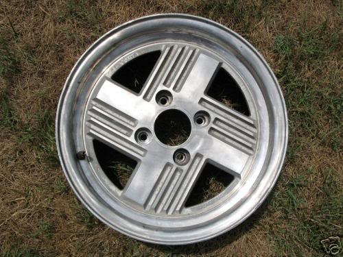

why do you need spacers?
The offset on the turbo rims is +12. I want to get spacers just to play around with and 25mm should put me at about -13. Plus i could rock my 002's with -25; weak off set is weak, remember? lol.

6" wheels with -13 offset is weak. Skinny wheels sticking out looks silly.
true but it still looks better than skinny battleships..and its always better to have a wider wheelbase..
Old Jul 18, 2007 | 10:38 AM
at the most run a 10 mil spacer in the rear. dont run 25mil bolt on spacers to a 6in wheel.
Old Jul 18, 2007 | 11:22 AM
eh i would have to disagree Brian, it's not battleship at all on an s13 with propper tires, it's actually very flush with the fenders. the wheels look great on an s13 without spacers, and you still want some tire inside the fender at the bottom of the body. it will just look really bad unless the car is super duper dumped. like hydraulics
