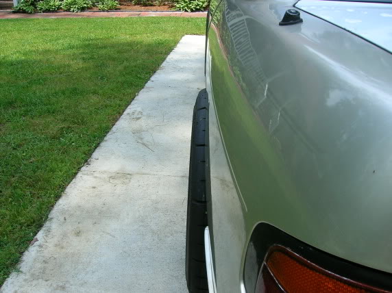

wassup guys...ive got a set of volk gtv's and the rears poke out too much... i was wondering of you guys could help me out on a different tire size to stretch on and if yall think that a roll and pull would tuck them under the fender.... thanx guys...

What size tire is on there now? looks like you could go at least 25 mm narrower and a thinner sidewall. add some camber, do a roll, and slight pull and it should fit fine. are you on carolinanissans?

its an 18 x 10 +23 offset....yea im on carolinanissans.... my name is madjdm69 lol

what's the tire size? looks like 275 or more. on 10" you can do 245

...oh and the tires are 265... f'in huge lol

would a 235 be too small??

I got 235's on 10 wide rims. You can also go 225 if you want.

Go 225.
