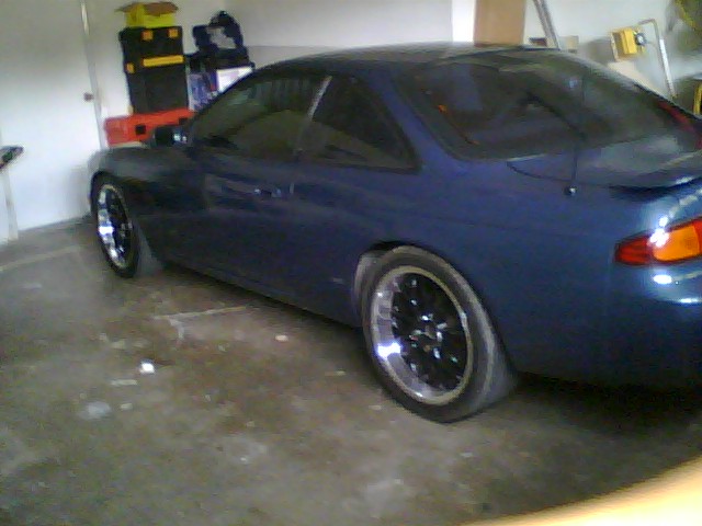

18 x9.5
I have 18 on mine im running 245-40-18 in front and 275-35-18 in rear i had to roll rear fenders ( very easy I used a hydro. jack handle) and it lowered.
