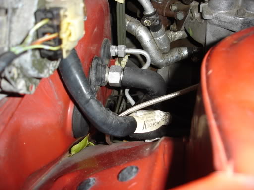

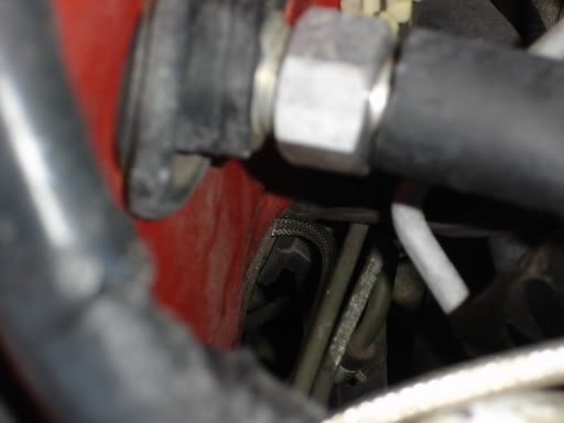

Okay, the wire goes into the fire wall. To the left of the block, down pretty low there is a tube that comes out and points down. And there it ends, i think it has to do with vents. You go through there, and the wire will come out up near the passenger's feet, next to the center console. Run it from there, behind the panels, under the plastic sill-guard(and rug), behind the rear panel, and pop it up behind the rear seat, from under the rug.
Here is a short, crappy quality video to show you (kind-of) where in the firewall it is.
http://media.putfile.com/Speaker-wires
If you look DEAD CENTER in this picture (below) You'll see a silver braided wire, its going around a rubber seal, into the firewall.
