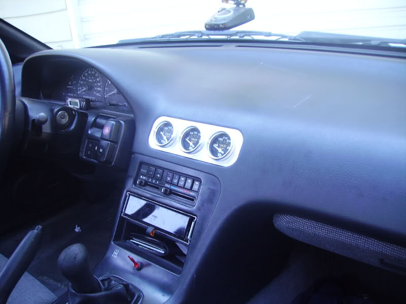

Removing the center vent is always a good way to go. You can get all 3 gauges in there. Splicing into the radio harness is the way to go for lighting. The gauges will dim when you dim your dash lights. If you need wire colors then let me know, I can go look for you.

that shyt looks pretty dope right ther man....id appriciate it if you could look into what wires i splice thm into. Is that your car? if so...howd u fab up that plate to hold the gauges? shyt looks hella clean dude....im deff diggn that look

That is not my car. I just have seen many like that. The plate is $15 on ebay. The colors that I used are... Actually I have to go look. BRB. Gonna go tear my car apart real quick.
Ok. If you are using a plug and play harness, the orange and orange w/white stripe will be your illumination. If you have to pull from stock harness, then the wire colors for a 92 SE (Not sure if there is a difference) are red w/blue stripe and there is a white mark about every 2 inches and red w/yellow stripe.
