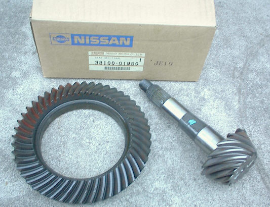

i dont know of a short gear box for the S13...or S14 off hand. but if i were you i would just alter the final gear ratio with a diffrent ring and pinion set. this will give you the fast acceleration....or higher top speed( if you please)
i have a 3.917 R&P Set for higher top speed

change the LSD ring and pinion and you will get acceleration....period
dont waste money on all that. the diffrential ring grar will effectivly give you the same acceleration properties as the tranny. plus with more HP your car will blaze the rev range like crazy....
trust me i know
http://www.courtesyparts.com/Merchan...de=38100-00005
i just got one to give me more high speed. so i can switch in either my high speed LSD or my drift LSD
