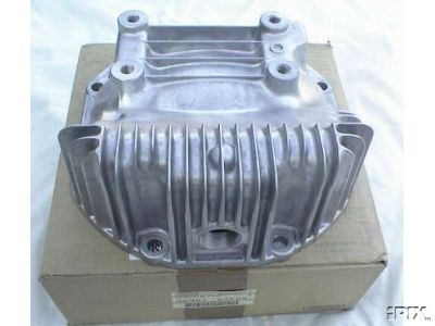

hey...those were my threads
you have a gang of options to choose from
you can get an LSD (complete rearend) from a 240 that was ecquipped with one...it will bolt right up to the car.
you can use a non turbo 300zx complete pumkin but have to switch the out put shafts to the 240sx.
then there are the lsd's from the skyline and j30 which will bolt up the same way as long as you put 240sx output shafts in.
i got an R32 skyline lsd with an S13 nismo LSD cover i cant wait to get it installed
there are probaly a couple things i forgot to add but that is the gist of it
