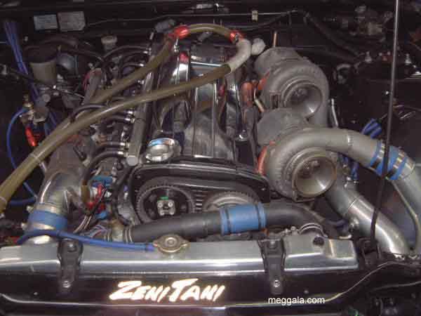

any of the rb motors fit in the silvia. including the gtr motor with the twin turbos. there is a 180sx or 240sx as you guys call them here in melbourne, with a gtr motor in it. At the autosalon, and it had two t88 turbos on it. thing spooled up at around 5000 rpm. 500 kw at the wheels. pretty much a show car. no chance of driving it on the street. wheel spin in all gears.
but for a gtr motor to fit u have to change the sump, but its basically the same sort of conversion as any other rb motor. except just the awd to rwd, and the extra turbo, which means extra dump pipe.

You forget the steering rack of the 240sx is in the way of the twin turbo set up of an RB26DETT. So you also need to do a single turbo conversion. Not worth it in my opinion.

u dont belive me, i'll try and get pictures for u.
People said that the rb25det couldn't be put in, and what was the result.
i know it has been done before, otherwise they'd just put rb25 in.
but i seen a rb26 in a s13. twin turbs too.

can u please tell me what this is?????
cant be done. well whats do see in the photo.

um...did you forget the US cars are left hand drive????
think about that...
we DO have RB powered cars here brah......
what..you thought we had no clue what we are talking about

well it can be done in an S13 as you see in the photo, not my fault u guys drive on the wrong side of the road hey???
never thought of that.
ahwell, so it can't be done in left hand drive cars.
fare enough, but that zenti car is weapon i'll say
