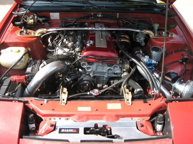

I saw your write up and wrote you a bunch of times. You helped a lot but there were just a lot of small things that made this project a pain in the ***. But i think everything is fixed. I haven't put the catch can on yet, but only because im lazy, so its pretty much hooked up like it was originally. Sometimes when i turn my car on it seems likes its going to die on me as the rpms go way low, but then they go back up. i think the coolant line to the turbo is leaking, and thats the biggest problem. it should be easy to fix, i just have to wait till the shop on base opens to get the car on a lift. until then i wont raise the boost over stock. but i like the new sounds of a bb turbo. i have noticed that the bov is quieter and i dont know why. well...heres a pic of the new sr.

Im glad i could help, as for the catchcan, i would really recommend gettin one inbetween the intake and valve cover, ive caught quite a bit of oil that would be going directly into your turbo, which of course isnt the best thing in the world for it.
