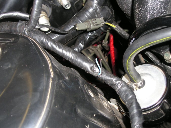

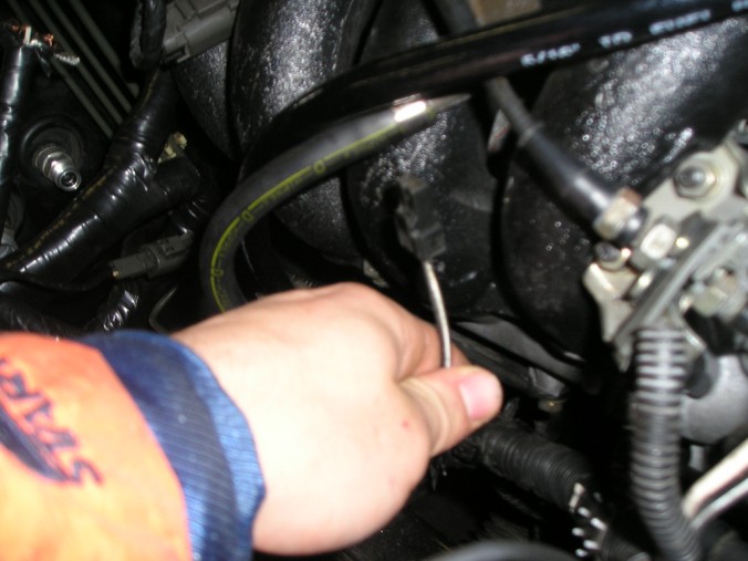

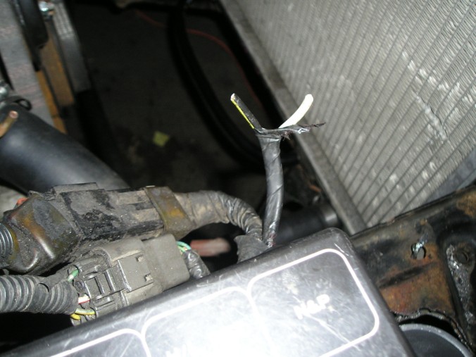

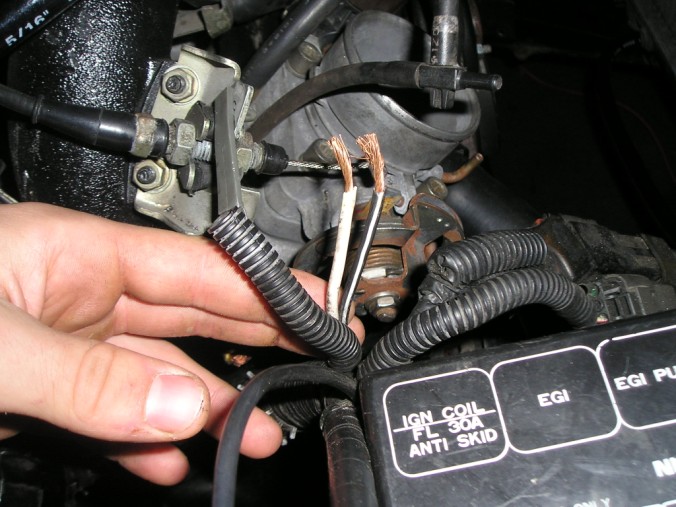

ok the first pic is the 2 wires coming from the fuze box which are black/yellow strip and one solid white wire the second pic is the 2 wires on the sr20 harness that i was talking about that were thicker these two are the same thickness as the first pic but the one is black/white and the other one is black/yellow i thought these might connect toghether since they are the same size and similar color but im not going to connect antything on guessing. the third pic is a plug that i dont know where it goes but it also is a black/white wire but only one wire. the fourth pic is the 2 thinner wires from the sr20 harness that are blue/white and one black wire. Thanks for your help

pic2

pic3

pic4

Black/white in pic 3 hooks to the starter. Black white in pic 2 should hook to the black yellow in pic 1 and the white in pic 2 SHOULD hook to the white in pic 1. No clue on the 4th pic.
I am NOT responsible for ANYTHING that happens to your car!!
I am 100% on the black/white and black/yellow going together, thats the start trigger wires. The white SHOULD go together, but not being able to trace it I cant say for sure.

the black/white plug does not go into the starter there is no place to plug it it i looked all over.

Do you have 2 wires hooked to the starter? Trust me, that goes to the starter. One large wire for constant power & that wire to trigger it to spin.
If you dont have 2 wires hooked to the starter & there isnt a tab for that to attach to, you need a new starter. The tab might have busted off.

is the tab located on the bottom of the starter

It is on the same end as the large cable, looking at the end from the front towards the back of the vehicle it should be around 8:00.
