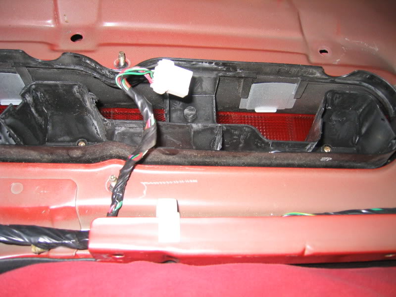

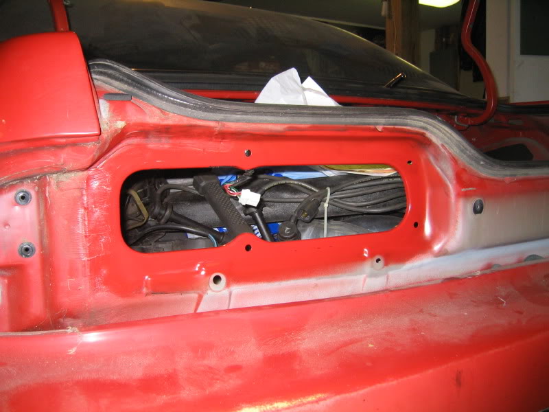

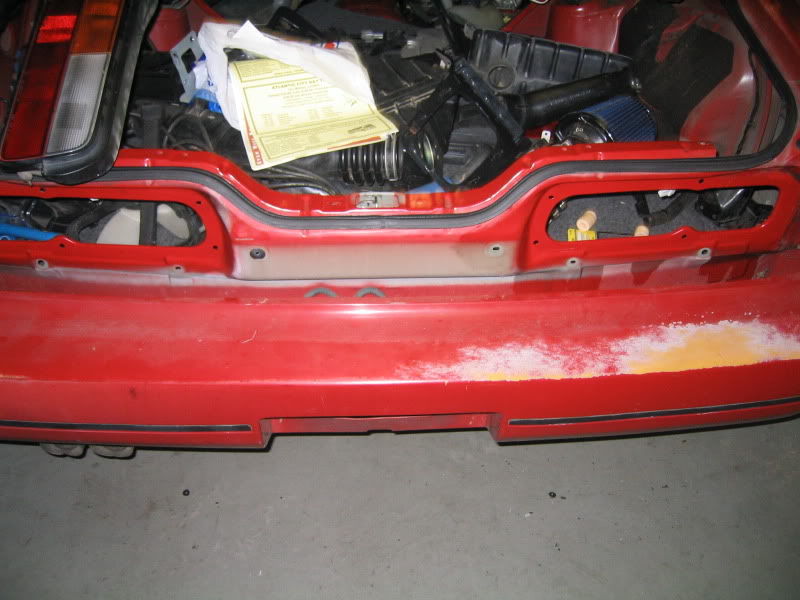

I dont know how it is on the fastbacks, but the tail lights on the coupe are made of two seperate parts. The one you see from the outside is a set of lenses and they pass through holes in the rear of the car and are bolted into the car and sealed to the back of the car by that ugly "tar" stuff. The actual bulbs are in a grey tray that locks into the light housing and is accessable from inside the trunk.
When I replace the tail lights after painting, I plan on using some good high quality RTV and make a real gasket that goes around the lenses and hole in the car. I dont think that that tar stuff is the best sealnt out there. There must be a better way.
Please ignore the crap in the trunk. Its been temp. storage since I dont have a ton of room to store parts I pull off of the car.
