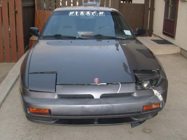

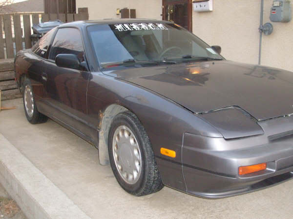

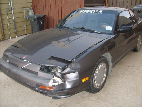

okay well here are what i have
to me it dosent look bad but im not terribly sure
Old Mar 15, 2008 | 03:11 PM
  #50
NiSmO Knight's Avatar
Posts: 1,432
Easy fix, new radiator support and straighten out the frame rail on the driver side. Pick up a head light from the junk yard and your good to go. Pick that up before someone else does!
Just noticed the crease above the front wheel, the frame rail/apron section might be out of alignment, but any body shop will be able to make it straight again with no problem.
