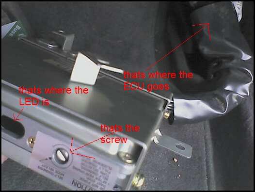

ok so I find the ecu, I have to disconnect the ecu box from the car to turn the thing clockwise and counterclockwise before I see any CEL or LED lights blinking?
Old Mar 15, 2006 | 11:15 AM
barcode's Avatar
Posts: 257
I had my ecu out doing the exact same thing so here you go.
Thats on a S14 so it may look a bit differnt , but it should give a general idea.
