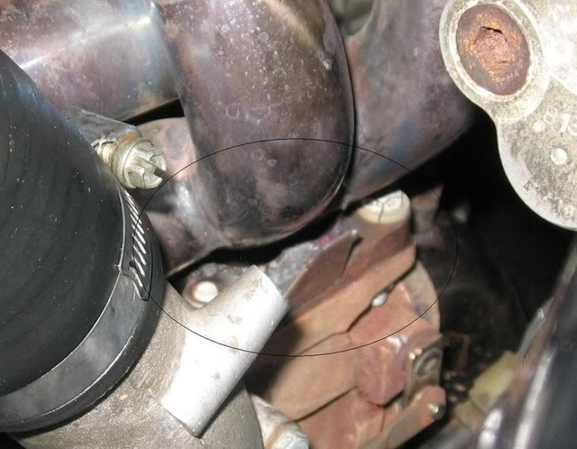

As to be expected, the exhaust manifold purchased from ebay cracked at the welds. R.I.P. - May 2007 to October 2007 You shall not be missed.
It really didn't have any reason, other then cheap, to crack. My down pipe is equipped with a flex basket, and it's only holding the weight of the stock t25 turbo.
Does anyone know where I can purchase a reliable exhaust manifold for the ca18det that will last longer than six months?

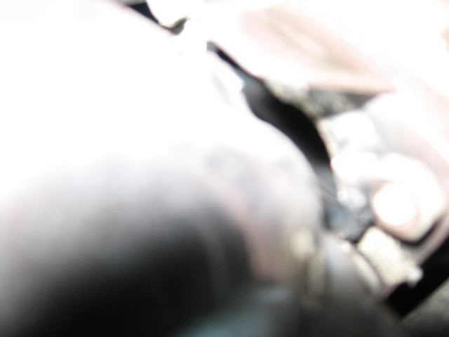

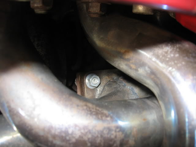

Got a little bored tonight, so I wanted to see what I had to do to get the flange to completely separate from the tubes.... which turned out not much. I did one full throttle pull from approx 25mph to 70mph, and that's all she wrote.
Even with the turbo completely separated from the engine, it was still drivable!
Should be a cinch to remove now that's its in two pieces too.

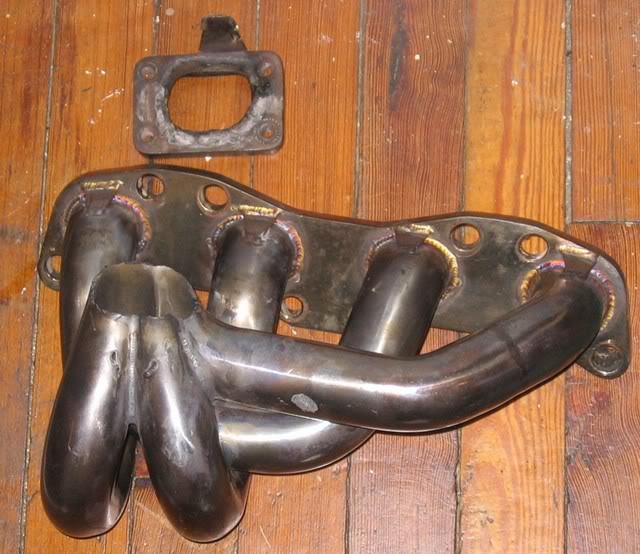

One last pic before it goes back to its maker.
