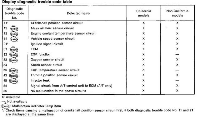

I can't figure this out, I ran the codes on the ECU again. I did it because for the past 2 days my CEL has been coming on. It will be off most of the time, but for periods (10 minutes to a half hour) it will come on, sometimes flickering on and off for 2 or 3 second intervals at idle. So I ran the codes, and right off the bat I get code 34 (knock sensor circuit), which in the FSM isn't even supposed to trigger the CEL to come on. That's the only code I get. I turn the switch back and back to test and it then gives me 55 (no problems). I'm stumped here.

Okay, but if there was more than one code stored it would have flashed it right after the knock sensor code, right? The FSM says that the knock sensor doesnt throw the CEL. How would the knock sensor make me fail emissions?

knock sensors DO throw CEL!! obviously, bc theres a damned CEL code for it!!

lol I know, I would "borrow" it from the junkyard but didn't you say it was a pain in the *** to get out?
Heres the page from the FSM. See, it says it shouldn't throw the CEL.
