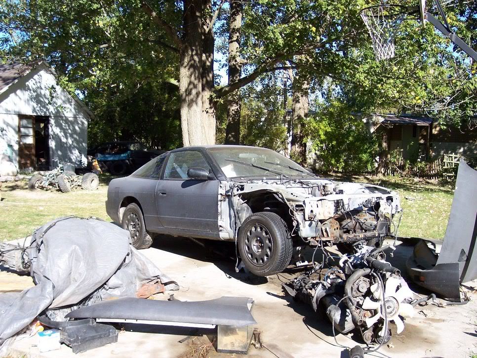

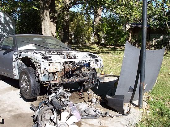

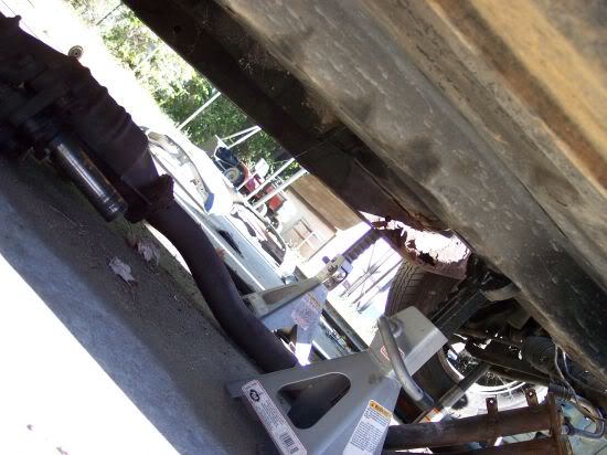

I have pictures here.. basically after all this background information heres what i need to know.... Some people are telling me I COULD go ahead and just do the swap and maybe not have that many problems but i would have to replace a lot of things and find a welder to help me out on some areas. Then some say i just need to buy a new shell or a better 240 and just cut my losses because if im planning to go a far way with this car i wanna be alright and do it right the first time. I already have a front mount intercooler and a CA18DET ready to go and in great condition. I wanna know what you guys think i should do... work with it or get a new shell... thanks for putting up with my long story and thank you even more for helping me if you can.. I appreciate it. I already posted this at ******** and dirftcentral just need one more opinion.
the rust looks a lot worse than this picture shows, plus on the other inner side its like that too but a bit worse

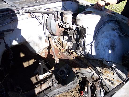

for some reason my comp is gay and is blocking most pics on the net, but if its as bad as you say it is, I'd try to find a shell that is in better shape, grab the good stuff of the rusty shell and swap it over and then do the engine...
that master cylinder has been leaking for a long time... brake fluid will kill a car in a heard beat... the rust could be fixed if there is enough solid frame around that area... yes you would need a good welder to do this... it is savable if that is the only location the rust is on the frame...

you said the body panels have no dents. try to find a non rusted shell with a bunch of dents and since you don't need the engine anyways try to find one that doesn't run. you said the interior is good in your original shell so put that in your new one. you should be able to find one super cheap if that's your criteria.
thank you for the help guys i really appreciate it. Theres a bit of rust in many spots on the underbody. It just doesnt seem worth the trouble ya know? But what do you mean that brake fluid kills the master cylinder? just wondering .
And you said theres a shell in TN?
brake fluid is highly corrosive to metal, you can see that huge rust spot under the master cylinder on the brake booster~ presumably from brake fluid leaking out of hte MC. Rust is bad news man, it's an infectious disease that really doesn't go away unless you do some SERIOUS metal work (i.e. cutting it and surrounding area out). I see lots of ppl from TN selling their cars on here all the time~ just be patient and keep your eyes open. You'll be back on the road soon enough.
