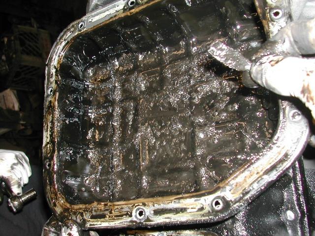

we got the engine on the stand and since we were going to replace the HG anyways and install some ARP studs and a few other things before we put it in the car, i decided to pull off the oil pan and that's when the nightmare started. the oil pan was absolutely FULL of metal. major bearing failure and draining hte oil on the engine at all should have made this painfully obvious. I decided to look at the rod bearings. #1 completely shot, gone, a little bit of material stuck to the crank and the crank was totally ****ed.. all of the other rod bearings were on their way out and had severe wear (copper showing)... i then pulled the mains out which also were all showing copper.
At this point we're super frustrated and pretty pissed off.... obviously the engine is completely shot and would need a complete tear down and everything would need tanked and rebuilt including the turbo (i've already experienced what engine bearing failure does to your turbo in quick order)

just for reference. here's one of the pics of the first engine..
remember they still wanted a COMPRESSION TEST after seeing this + a ton more pics, after the engine was almost completely disassembled for full diagnosis
