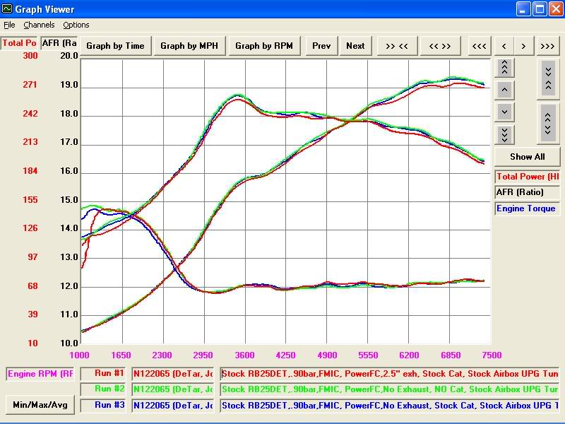

Old Nov 17, 2009 | 02:22 PM
From: kennewick wa.
red is with the stock cat.
green is open down pipe.
blue is no exhaust but with the stock cat.
here's a dyno from a rb25det, if the numbers don't change much between having open exhaust and the ever so restrictive cat on a rb, do you really think there will be any change with a ka?
