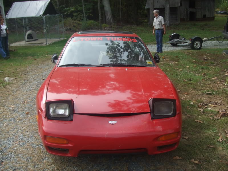

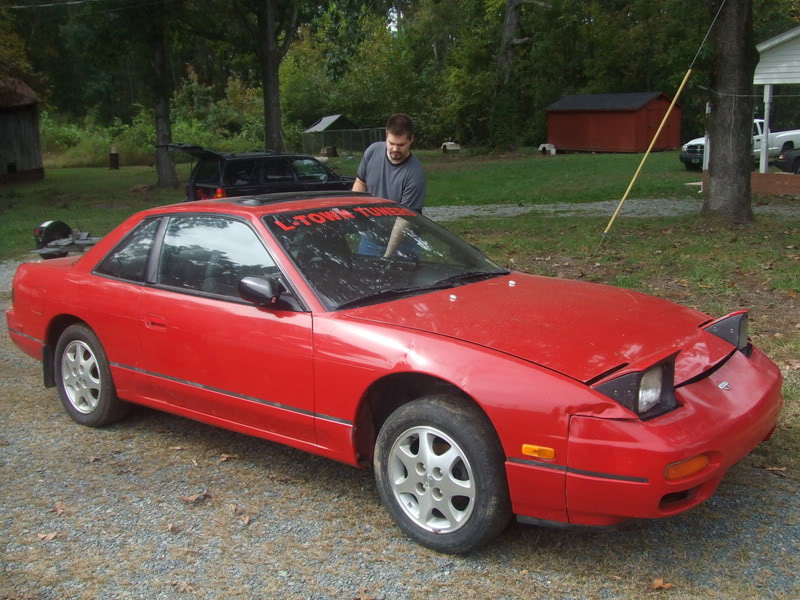

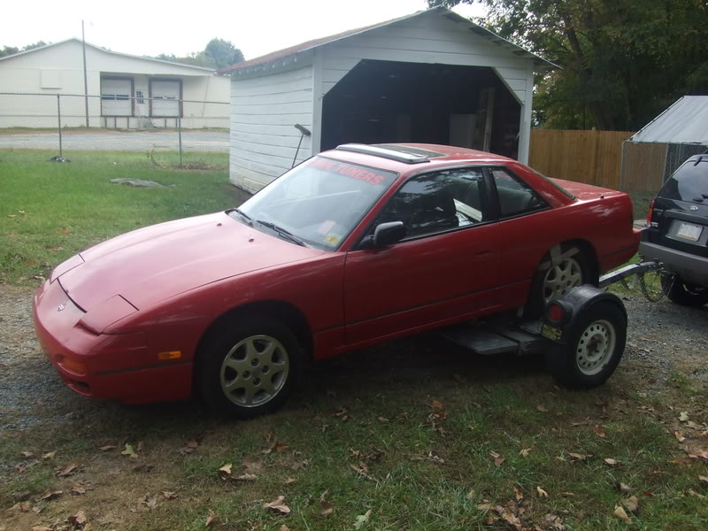

As requested here are some pics of the car when we picked it up. Ill have more of the car in the garage later tomorrow.
