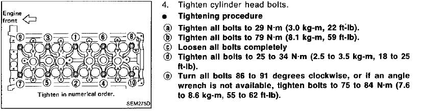

those are the cylinder head bolts...use this procedure

no... those are the wrong ones... they're the bolts on top of the cam... they hold it in place... i'm talking about the ones that go here....

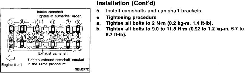

here's the diagram for the ka24de...i know you have the SOHC but regardless the torque is the same.

ohh, you're showing me the dohc motor... mines the sohc...

see edit...

alright thanks... that just didn't seem like any torque to me... I figured it would be tighter.

you dont need that much torque for those bolts...remember the brackets come in contact with camshaft itself, if you torque them down too much you'll risk snapping your timing chain, or worse seizing the valvetrain (sqeezing the oil out from underneath the bracket).

the main reason you dont want to torque em down tha tight is they are in aluminum... and they will strip rather easy... i know what im talking about when he showed the pics... he did not realise i told him the same thing you were telling him... eith way... i guess he got it done...
