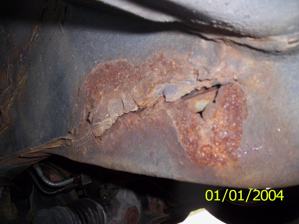

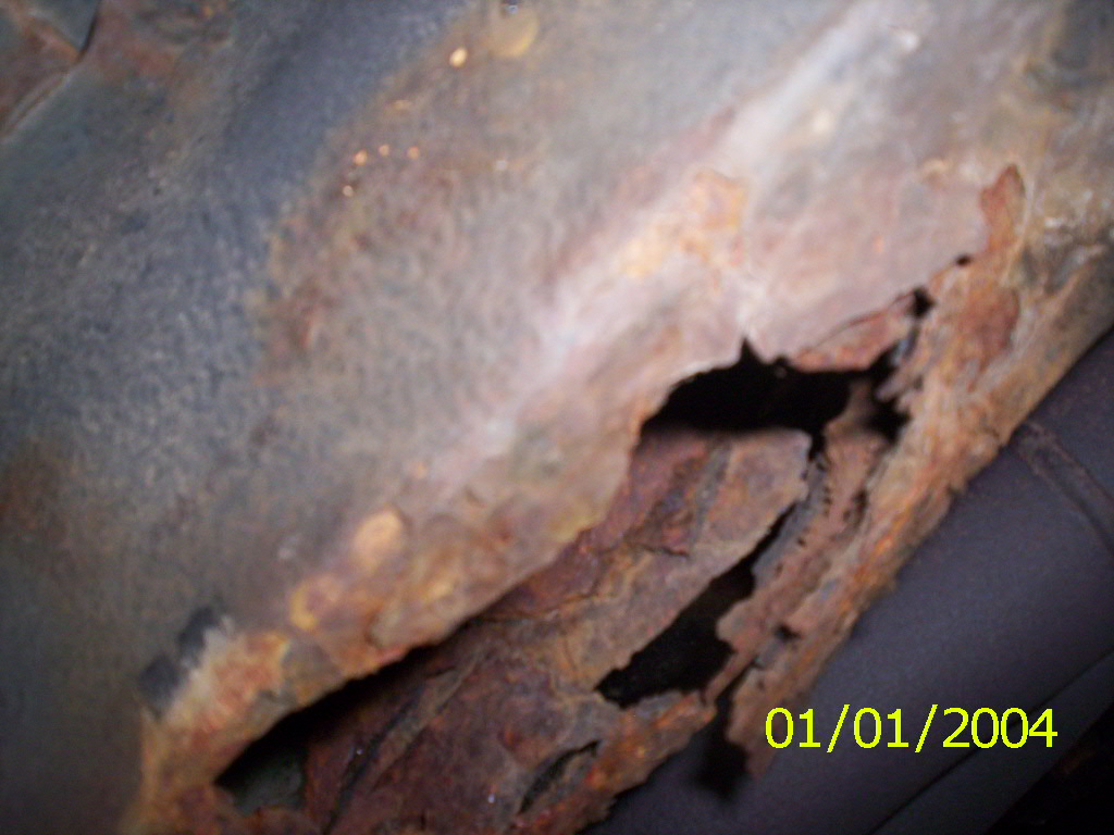

hey i need some advice..i put the front end of my car on jack stands last weekend and i put the jack stand on the frame and i guess it rusted through and broke through...ill get pics up and i have a hole in my passenger floor board..and the rear wheel wells and hatch lid are rusty typically...should i keep the car and repair the rust and drop my ka24det engine into it when i get it done or just buy another s13 with less rust?

well, personally, i woulda steered clear of rust, and also, next time support your car from the chassis, not the floorboard
Old Mar 26, 2007 | 08:54 PM
that not a critical part of the car. put some sheet metal on it and move on. guess im a lil harden.
its like a guy who comes off the football field becuase someone stepped on his hand..... hmmm ok... get back in the game and suck it up...
your find bro.
Old Mar 26, 2007 | 08:57 PM
I'd say it depends on how bad the rest of the chassis is rusted. Check out the entire underbody and frame and see if it is even worth fixing. It may end up being a bigger task than its worth.
Old Mar 26, 2007 | 09:02 PM
From: kennewick wa.
i'd say get rid of it if it has too much rust. but it depends were the rust is. like biggamehit said if it's not on a critical part sheet metal it.
remember that this car should be safe to drive, you don't want to spend a lot of money on something that will literally brake down while driving it.
Old Mar 26, 2007 | 09:08 PM
^^^agreed. you can weld in new sheet metal in badly damaged areas (floorboards.etc) and if the rust isnt too bad you could always sand down and use a rust preventive/sealer paint like POR-15. I really like that product as it really helps keep the metal free of corosion, if properly applied.

oh my god, pics if the rust is bad enough to go through the frame (which is still astonishing), ditch the car
Old Mar 27, 2007 | 01:27 PM
yea man i had rust issues but through the frame rail is bad bro.

[ATTACH]Need Some Advice-pictures-054.jpg[/ATTACH]Click image for larger version
well there is some of them i dont know how to add all of them how do you do that?
Old Mar 27, 2007 | 03:16 PM
alot of the east-coast winter cars, or cars that spend time in the snow usually have some rust damage. I think its just normal especially with all the salt on the roads after clean-ups. get those pix up so we can have a look see
