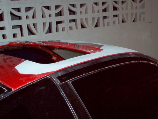

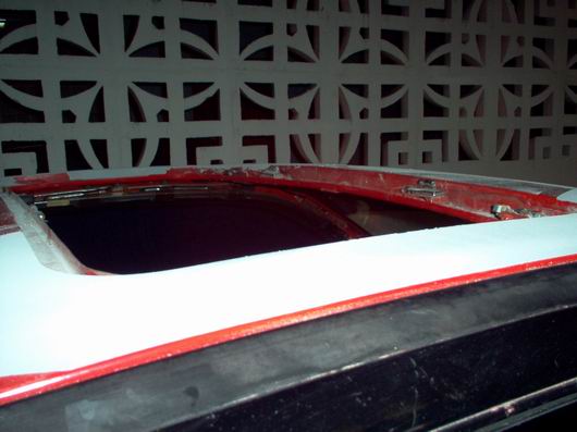

Well Got to work on the car took out the seat and cleaned up ALOT OF GLASS!!!! Got at least 5 crystal splinters in my fingers but I got it done and then removed all the upper moldings and roof upholstery and started doing the body work and that was yesterday and today at night I just completed the body work and its the first time I ever done it.
Here is what a Did
1. With a jack and a long 2"x4" I jacked it up to the sun roof frame and lefted it up to about right but then there where a bunch of bad dents everywhere.
2. Bought a grinder and grinded off all the paint on the dents.
3. Alot of feathereding(my thumbs feel like there going to start bleding).
4. some crappy body filler and alot of sanding it looked bad.
5. I had to get some glaze and to all you DIYselfers!!!! BUY GLAZE!!! APPLY IT AFTER THE METAL/FIBERGLASS FILLER!!!!.
It turned out soooooo smoooootthhhhhh.

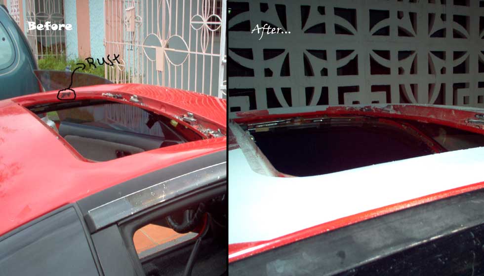

6. Oh and I bought some self adheiseve bondo pads and all you have to do is peel of the back and place it over the hole and metal filler over it and it turned out nice seeing as my roof had 2 very not visible rust holes so I just took advantage of the situation and I fixed it.
7. More feathereding(It is so horrible but it has to be done).
8. Finally primed it and wholah it is a roof again.
pics of the final stage except its not sanded primer I leave that b4 paint.

Hey guys whoever said leave body work to the pros should go **** themselves cuz I certainly didnt have that kind of $$ so I did it myself instead of getting rid of my baby which I really cant imagen doing.

true Nissan love for my car.
