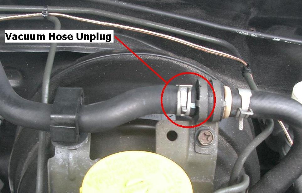

>To see where the vacuum hose is look at pictures.
> Use a fine long funnel to pour the Sea Foam Liquid thought the hose, allow your engine to breath while pouring it. (That means go-slow)

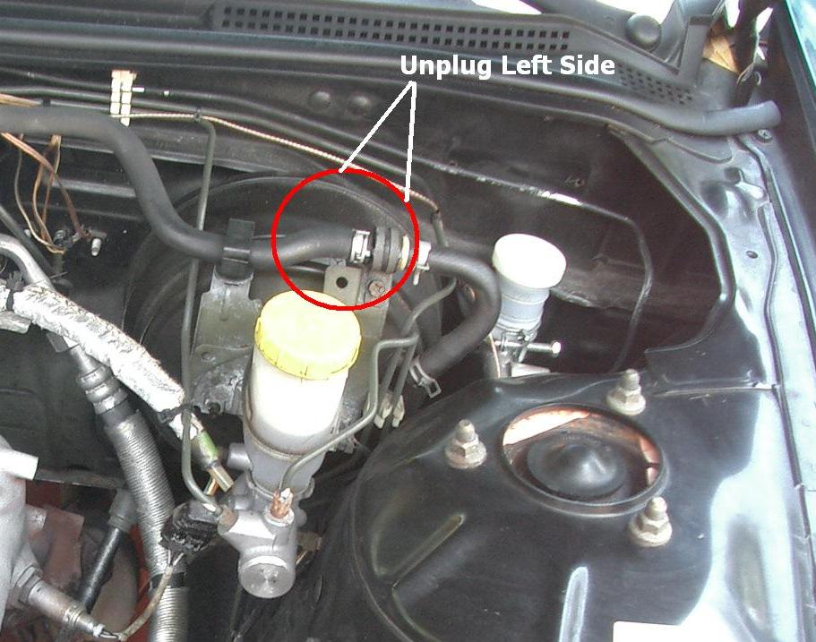

More detailed picture on location of Vacuum Hose

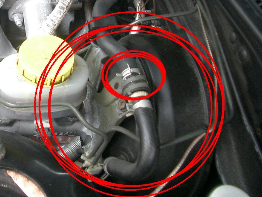

I forgot to add the last pic

what year was that pic of? I have a 93 and I don't have a vacuum line in that area. Can someone let me know where the vacuum line is I need to use on an s13?

My car is a 98 240sx
