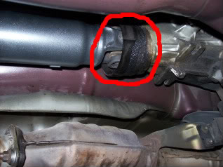

So I am afraid my transmission may be leaking, there is fluid drips under the center of the car, and when I crawled under there I saw fluid on this piece:
Now, the fluid appears to becoming out of the rear of the transmission, and then getting on the driveshaft as I drive, because there is fluid residue all around the underbody where the rear of the transmission is and the front half of the driveshaft (as if the fluid leaks onto the driveshaft and then it gets sprayed onto the underbody by the spinning driveshaft). Best pic I could get of this:
Zoomed in, On the above pic the bottom darker half is where oil got to, the top lighter half is the way it should be (you can also see this in the first pic, all that dark red color is where fluid has been).

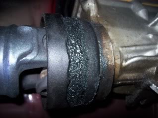

Now this is the piece that fluid seems to be leaking from:
So any ideas where I might have this leak at? I'm 99% sure its tranny fluid and not engine oil. However with that much fluid leakage you would think the fluid in the tranny would be low, but it's not, and the engine oil isn't low either. Also, whatever that piece is in the above pic, is it suppose to look like that (it looks rather torn up, but I ave never looked at it closely before)? Also, there is about 1/8" play in that piece, as in it travels forward to backward across the driveshaft about 1/8" distance, is it suppose to do that?
So, any ideas guys on where to find this leak at?

The piece you are talking about is just a dust cover from what I have been told by a few shops and can actually be removed by tapping it with a hammer. As for the leak, there is a transmission seal right in front of the drive shaft, maybe that seal is leaking some fluid.

it could be the seal but i don't recommend you get rid of the dust cover.
