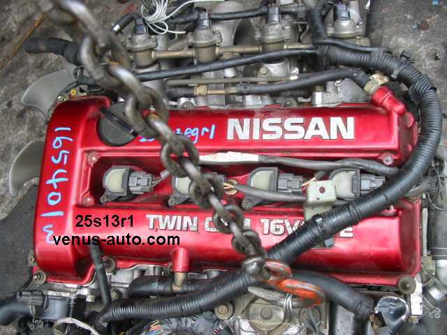

tanks for helping me with this problem..the other thing here is a picture that part i was talking about it's that ting on the bottom of the picture,that gold looking round thing motor ???is it a stock blow off valve??or what??....... your car is one bad *** silvia,do you know anyone who what's a pair of those headlights??well thanks again and as soon as i put my front end on i'll put some pic's...................... thanks
The only thing that resembles the picture and would be around that area would be the wastegate actuator. If it is held on to the turbo by a bracket and has a nipple coming off of it for a hose and has an arm sticking out of it, then that is what it is. If not, I can't tell from the pic.

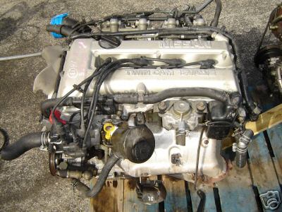

how about this picture>>????where does those goes..is that the blow off valve....

here's the big picture,..hopefully i done a better job find the picture......... thanks

That is the EGR (exhaust gas recirculation) if I am not mistaken. It is used for emissions and is also not needed. The stock BOV is mounted on the sidemount intercooler.
