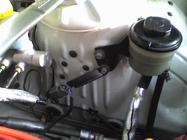

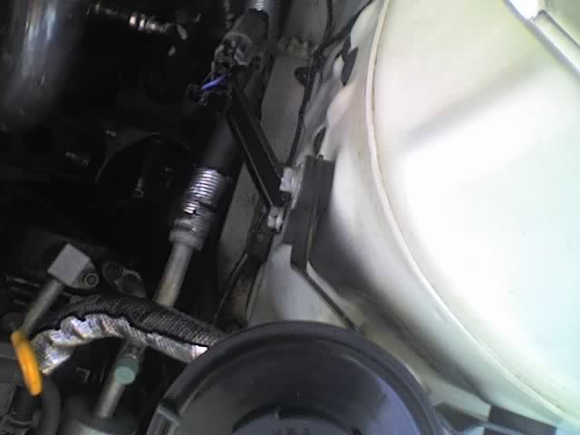

When I installed my header I could no longer attach the O2 sensor bracket since the heat shield is no longer used so I had it zip-tied.
I was cleaning up my garage and found the old bracket and wondered if I could reuse it somewhere on the fender side of the engine bay. Now normally you don't want to attach something that was attached to the originally to the engine off the engine since it torques and can snap things easily. In this case there is enough slack esp considering the engine torques toward the passenger side...
Here is how I did it by attaching the original bracket to the power steering reservoir bracket (painted it satin black as well).
