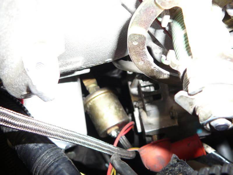

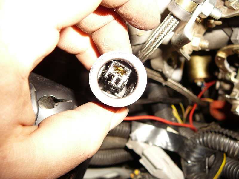

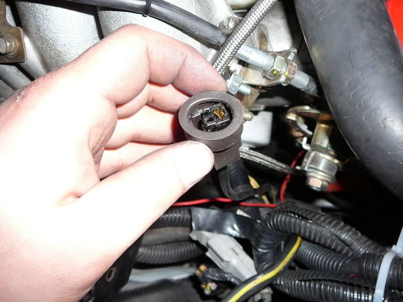

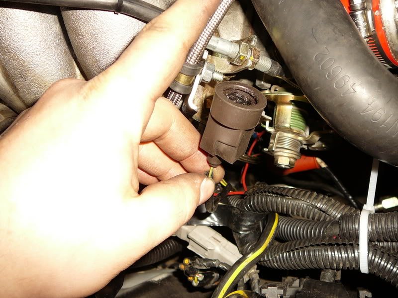

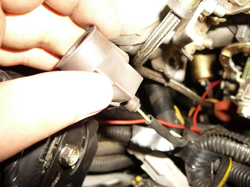

I was repositioning my intercooler piping today and i was just about to call the job complete when i found this wire that was not connected to anything. I didnt take it off, so i dont know where it goes or what it is for. The car is a 95 240sx KA24DE, the wire is yellow with a green stripe. Can someone tell me what it is and where it is supposed to go? 1000 points if someone had a picture of where it went lol Thanks!

oil pressure switch. check for the plug located near the oil filter.

hmmm thats what i thought it might be originally but mine doesnt look like that pic or look like it has a spot for it to plug into??... i'll take a picture and post it up, give me a second

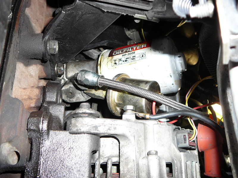

Heres a pic of what i have, what happens if this is unpluged? I'm wondering if i was ever plugged in wouldnt i see a light or something on my dash?, i have an aftermarket oil pressure gauge so i am thinking the original sensor may have been ditched in favor of the aftermarket sending unit?

you already have a oil presure sending unit so don't worry about unpluging it. a light in your dash might come on but that's all.

okie dokie thanks everyone! I fired it up and no light so and my after market guage worked fine, thanks again for the help!
