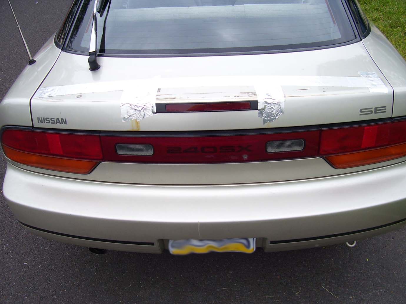

the person before me started to get rust on his hatch and decided to take his wing off ,theres only rust where the 2 big holes are all the other small holes are fine, so he put shiny duct tape on it so water doesnt get into the hacth and looks like sh*t ,what can i do till i get a different hatch so it doesnt look as bad .the color of the car is that champane/silver color , i was thinkin maybe a different color tape so it doesnt stand out as much, any ideas?

here hwat the hatch looks like with the tapeName:  hacth.jpg

Get some vinyl that is a close match to your color and lay it over it. I used red electrical tape on my old hatch.

why dont you just bondo and repaint it?

I only used the tape on the big holes, the smaller holes I bondo'ed over and never finished. I'll put some pics up in a min they're on my other pc

yea i had a couple of big holes. your supposed to fill them in with fiberglass then bondo over them. i did it the cheap way a suffed duct tape ***** in there then bondoed over it, lol. it came out pretty good. if i try to press on it hard it will probably break tho. but i only paid like 5 bucks for the can of bondo and like 5 for primer. still havent painted it back to white yet.

ideally you would weld a plate under the holes and, use body filler to smooth it out. luckily i have a wingless hatch but i still have to bondo my thrid brake light, wiper hole, and antenna hole. being the zipties and ducttape kind of person, i am just going to tape mesh on the backside and bondo them shut.

glue pieces of metal underneath and then fill with resin and glass mat and then bondo
not to big of a job really
