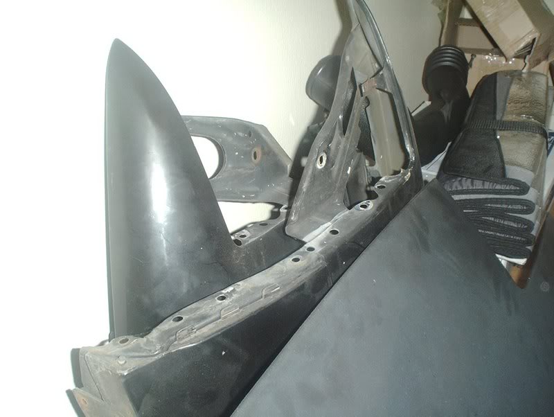

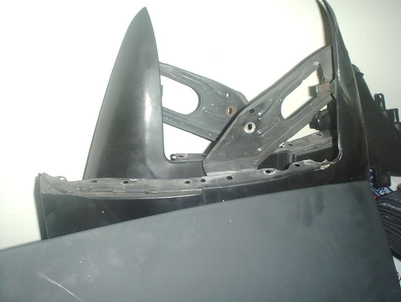

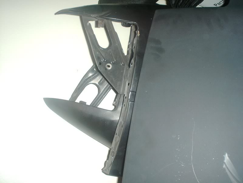

Pics for reference! 10mm bolts on the fenders by the way.
