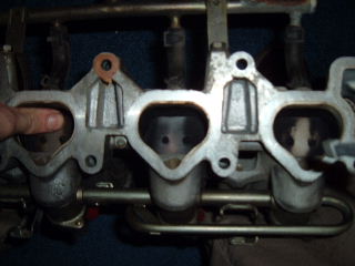

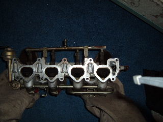

I have my intake mainfold off and i herd about removing the secondary butterfly for better air flow and hp but would this also cause it to run rough idle then??? true?
I have the pic posted because Im not sure what all needs to be removed.. I guess just so those plates inside the intake ports held in by a rod with screws... correct??

you should really think about if you really want to remove them. the reason many people seem to get better performance afterward is because they were not functioning properly to begin with.
their purpose is to add more swirl to the air before entering the combustion chamber. this swirl allows better atomization of the gas as it enters the air stream. at idle/slow speeds this is beneficial. in cold weather its really important as cold dense air doesnt mix well when the fuel is injected. this all inportant swirl control valve also contributes to the ka's low end.
so yes removing them will improve the top end as stated before. but its a trade off. imho unless you have lots of mods or are going turbo, its not really worth it. but hey if you have access to a dyno, then test it out by doing a before and after test to see what your gains are. then post here so we all will know.
