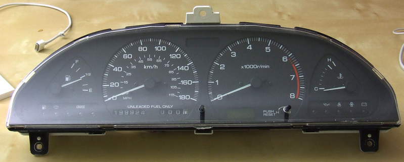

My car doesn't have it. On the lower left indicators, there are 5 lights. On mine, only 3 are active. Mine has a low fuel light, low washing fluid light and cruise. The 3rd and 5th lights (from left to right) have no markings.
Here's a pick I found, my cluster is exactly the same.

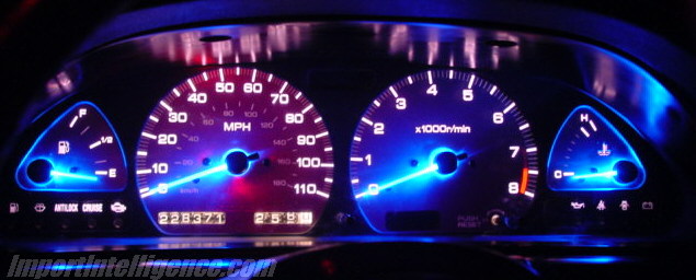

I just found this pic of a cluster with Check Engine light, it looks to be the 5th indicator, as the 3rd would be anti-lock.
