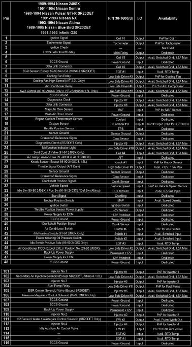

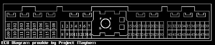

Secondly I am not at my apartment right now, but I do have the ecu diagram that you want for the KA24de pinout.
If you happen to ever work on sr20de's and you have the pinout for those ecu's they use the same harness/wiring diagram.
The problem may not be the ecu it could be a relay. I'll double check when I get home tomorrow if you still need the info...
Thats, interesting, so ill need to get me an auto ecu
I have worked on sr20de and sr20det, i do have the wiring diagram's. But if you can get me the real KA24DE diagram that would make me happy
If i swap to auto ecu, were does the ecu gets its speedsignal from?
